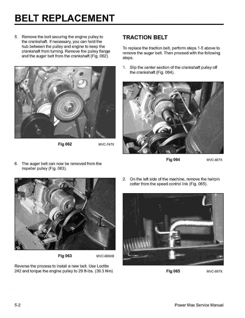

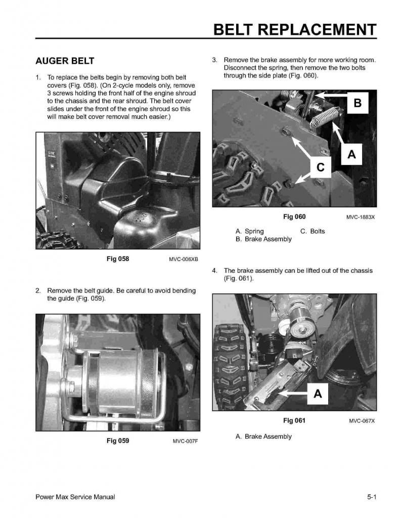

Ive removed the top belt cover to take a good look. Looks like Ill need to remove the belt guide that is bolted over the engine pullies to get either belt out. The auger/impeler belt looks like it fairly easy to take out except there seems to be a friction brake that I will need to pull back away from the driven pulley to slip the belt off. The motion drive belt looks a bit more of a PITA as Im not sure there is enough slack after the tension pulley is pulled back to get the belt off the engine drive pulley as that pulley is recessed. Im wondering if I need to take the engine pullies off. They are held by one bolt on the end of the crankshaft but Im not sure how to hold the crankshaft from turning to undo that bolt. I want to replace them as they seem a bit stretched as they are 7+ years old.

I ask because of the two that is the one that seems really loose (stretched) and that I want to replace. When I pull back the tension pulley there is alot of slack but because of the way the crank pulley is recessed and is the inner of the two pullies on the crank the belt will not slip over the outer pulley so the only way it might come off is if it will slip off the larger driven pulley first. If not I think the crank pullies will need to come off and I dont know how to hold the crank from turning to get the bolt off.

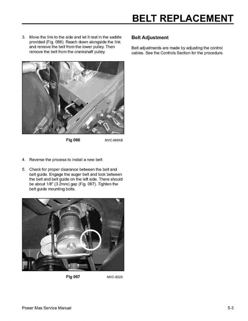

I have not pulled off the lower cover yet. In looking at it some more one concern I have on the motion drive belt is trying to snake the belt between the lower (driven) pulley and the friction wheel that presses against it when you engage the motion drive. It doesnt look like there is alot of clearance there.

I didnt see this last post. I will check the pulley bearings. I read through the manual and there are some steps in the belt replacement procedure I would not have guessed if I didnt have it. Thank you for all your help!
