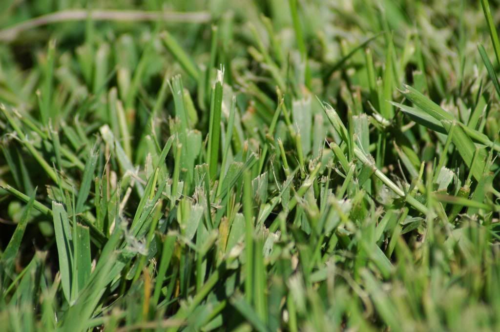

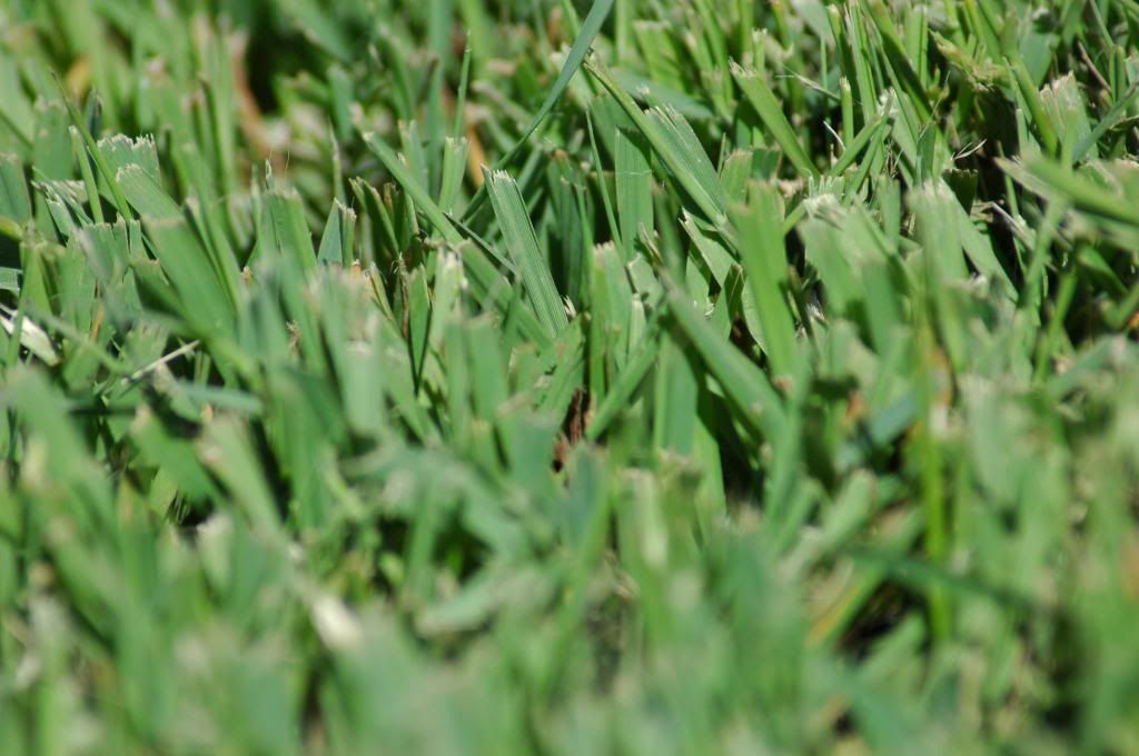

I purchased a JD 105 riding lawn mower from a store. They told me that the tractor was serviced by JD service and ready to use. I cut the lawn once and I felt that the mower's blade might have not been sharpened. When I touch the lawn it feels rough. I took a couple of pictures for you. If anyone can share their feedback that would be appreciated.

I can't see your pictures. It should be easy enough to look at the blades to see their condition. If it's a new tractor the blades shouldn't require sharpening.

You should be able to see the pics, Wayne; they're visible. What he means by rough is that the individual blades of grass are not cleanly cut, but have more of a torn appearance. I don't think that's uncommon with a rotary mower (as opposed to a reel-type that shears the grass blades off).
My first thought is that they (JD) put the blades on backwards. In other words, its cutting with the back of the bade rather than the front or sharp side.
They do look a little torn/ragged to me, but were those pics right after cutting? Shouldn't have browned that fast.
I also think it looks a little short on the cut? Kinda stemmy looking. 2-3 inches is about the minimum for most cool season grasses. Never cut more than 1/3 the blade length at one time.

I cut the lawn on Sunday, so that it's been about 2 days. I adjusted the setting to number 3 on the mower. It also looks short to me but that is the setting. My neighbor gets a lawn service and they have the same cut length. Their lawn does not look like torn. I live in Upstate NY.
