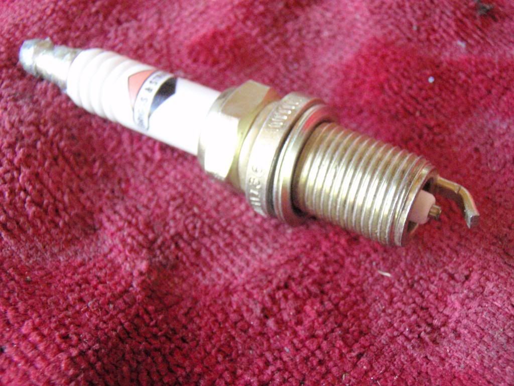

New Champion RJ19LM spark plug was gaped and installed. I get a good blue spark with cold or hot engine. After running, plug reads a dark tan color on the insulator and black carbon on the outer surface. Plug does not wet foul after failure to start.

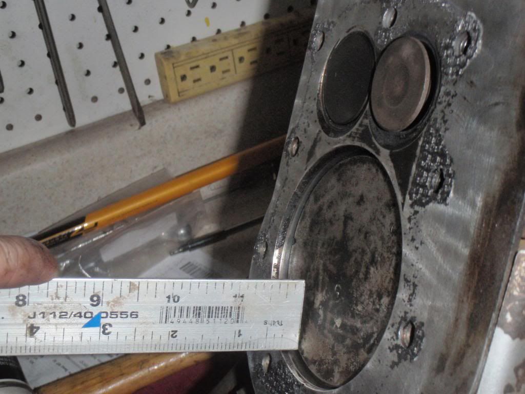

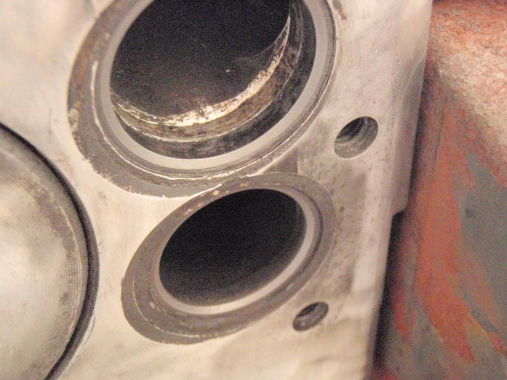

On the exhaust stroke, with the exhaust valve open and the piston on the up stroke, the intake valve begins to open when the piston is about 1/4 inch from TDC. At TDC, the intake valve is about 1/4 way open.
I can put a degree wheel on and give you specifics when the intake valve opens, or I can put a dial on the piston and measure inches before TDC the intake valve opens if desired. Maybe it would be better to just post a picture?
I would expect a little valve overlap, but it does look excessive
Old 08-19-13, 07:25 PM
Join Date: Aug 2013
Posts: 10
Cheese,

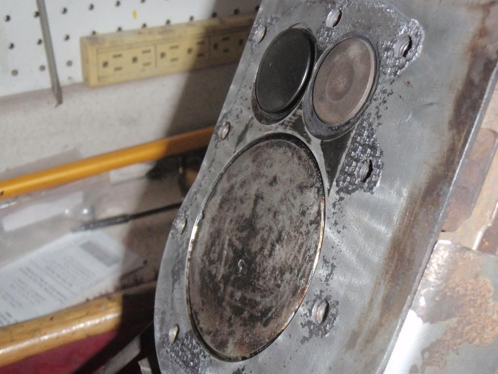

The more I check the valve timing the more it looks like you have identified the problem.
In this picture, the piston is 3/8th inch before TDC on the exhaust stroke. The exhaust valve is open and the intake valve is at the point where it first begins to open.
In this picture the piston is at TDC on the exhaust stroke. As you can see the exhaust valve is still slightly open and the intake valve is way far open This explains flames backfiring in the carb
As I rotate the crank through all the strokes, the valve timing is out of sync at each one.

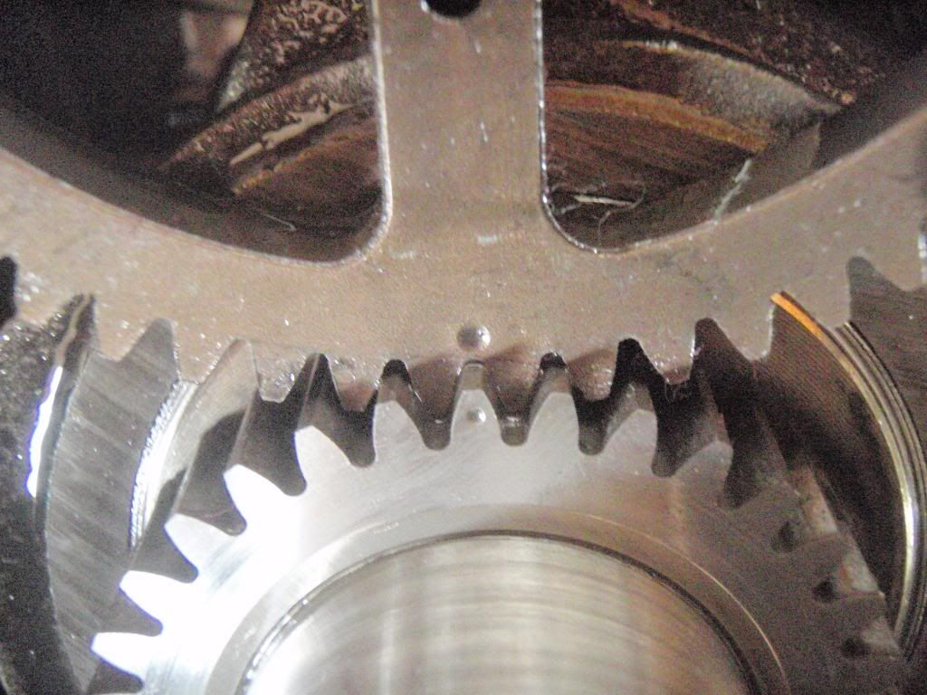

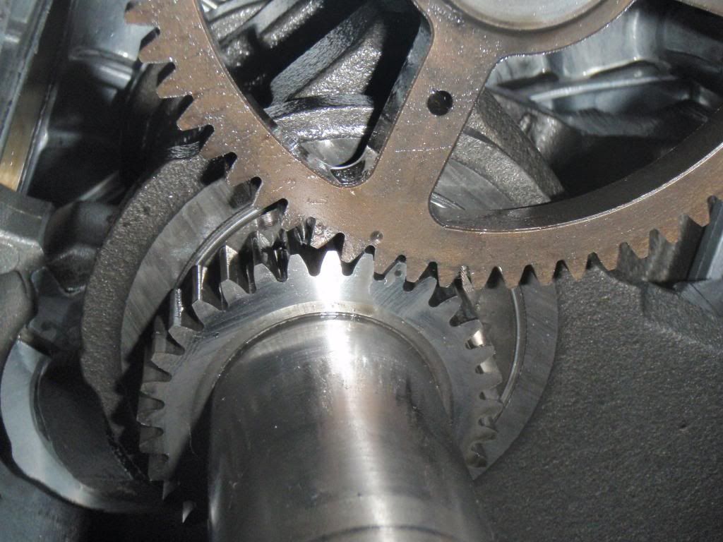

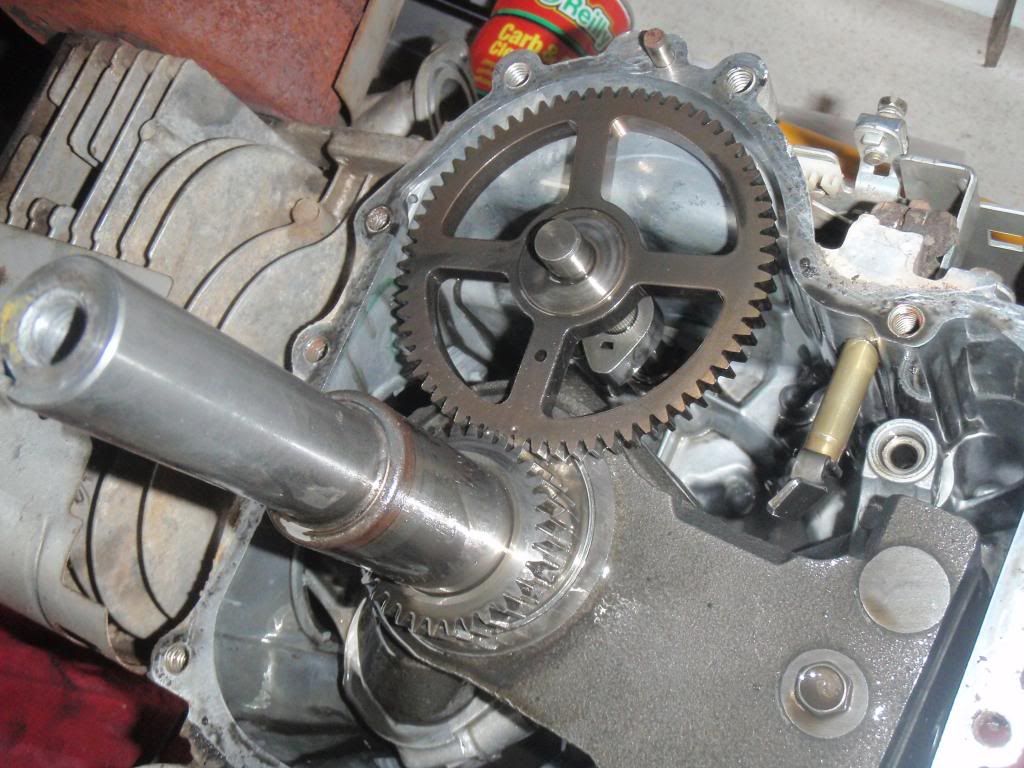

And the answer is...cam gear misaligned one tooth
This is the alignment I found after splitting the cases. Not good :NO NO NO:
This is the correct alignment

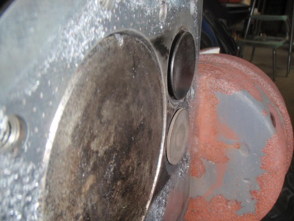

In my earlier thread I posted a picture with the cam misaligned and the piston on the exhaust stroke at the point were the exhaust valve first started to open. I stated it was 3/8" before TDC, but it is actually 7/16". In this picture the cam is aligned, which moved the piston within 3/16" before TDC.
Next photo please
In this picture the cam is aligned and the piston is at TDC on the exhaust stroke. The intake valve is open, but not as much as the misaligned cam photo. The big difference is on the misaligned photo the exhaust valve was slightly hanging open. But, with the cam aligned the exhaust valve is closed
So the conclusion is there is a valve overlap even when the cam is aligned properly

Valve overlap has nothing to do with timing of the cam but their relationship is significant in the application of the engine.. The latter is indexed on the crank while overlap is the relative position of the intake and exhaust lobes on the cam.
That cam lobe is pretty typical, outside performance products.
You've done a nice job documenting this. Everyone will appreciate it.

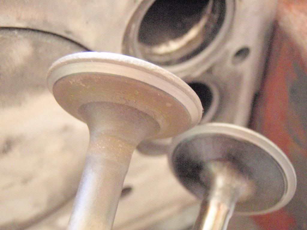

After I bolted the cases together I installed the engine on the mower. Then I started work on the valves.
I lapped the valves and valve seats until they had a nice even surface.
It took a little while, but they cleaned up nicely.

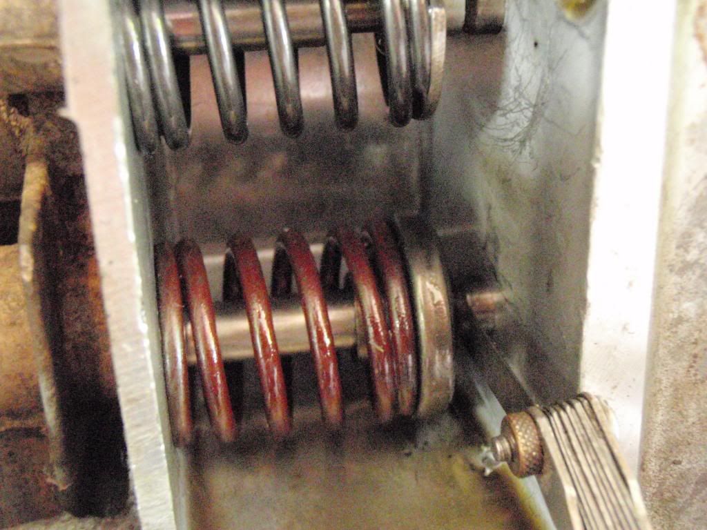

Then I carefully ground the ends of each valve stem to the specified clearance.

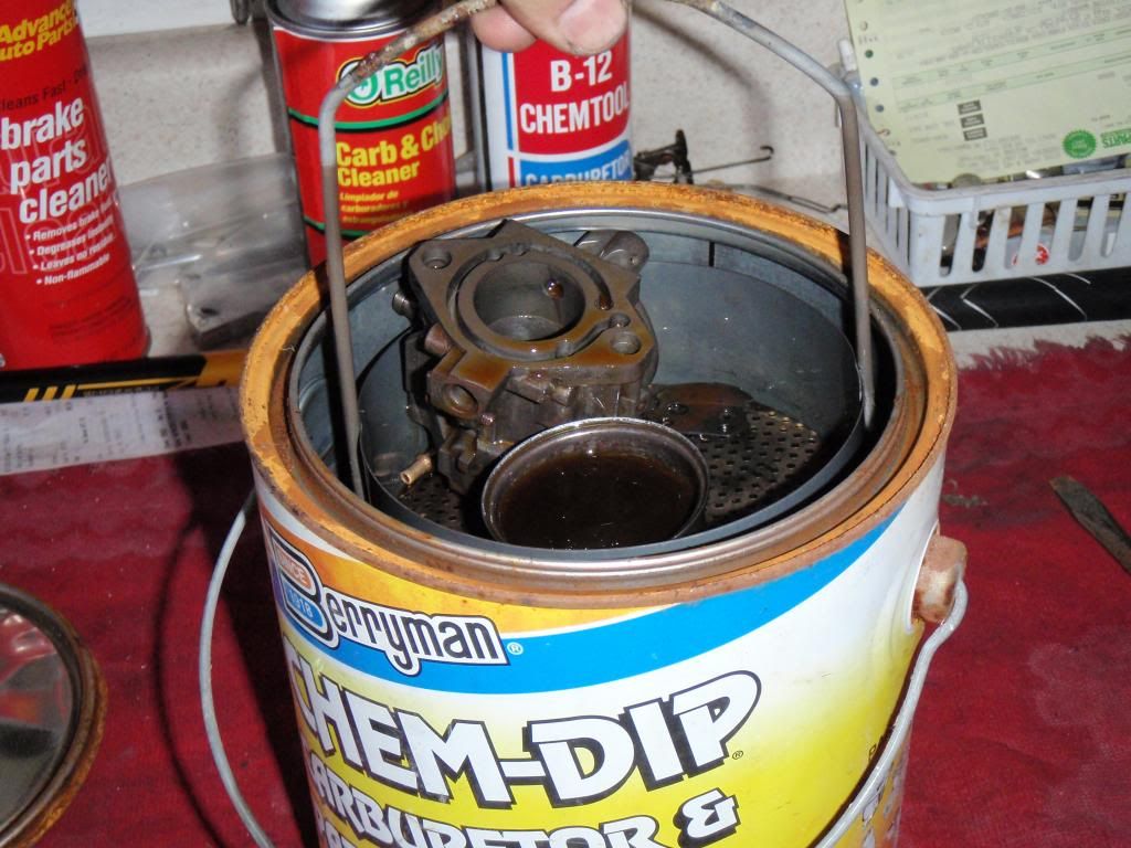

Remember that carburetor I started soaking about a week ago?
Ahhh...nothing like the smell of Berryman Chem-Dip in the morning.
Here we are all cleaned up an ready to go.
So, at this point, the cam is aligned properly, valves are lapped and adjusted, and the carburetor is spotless clean. This engine should fire right up, right...NO...fail again!

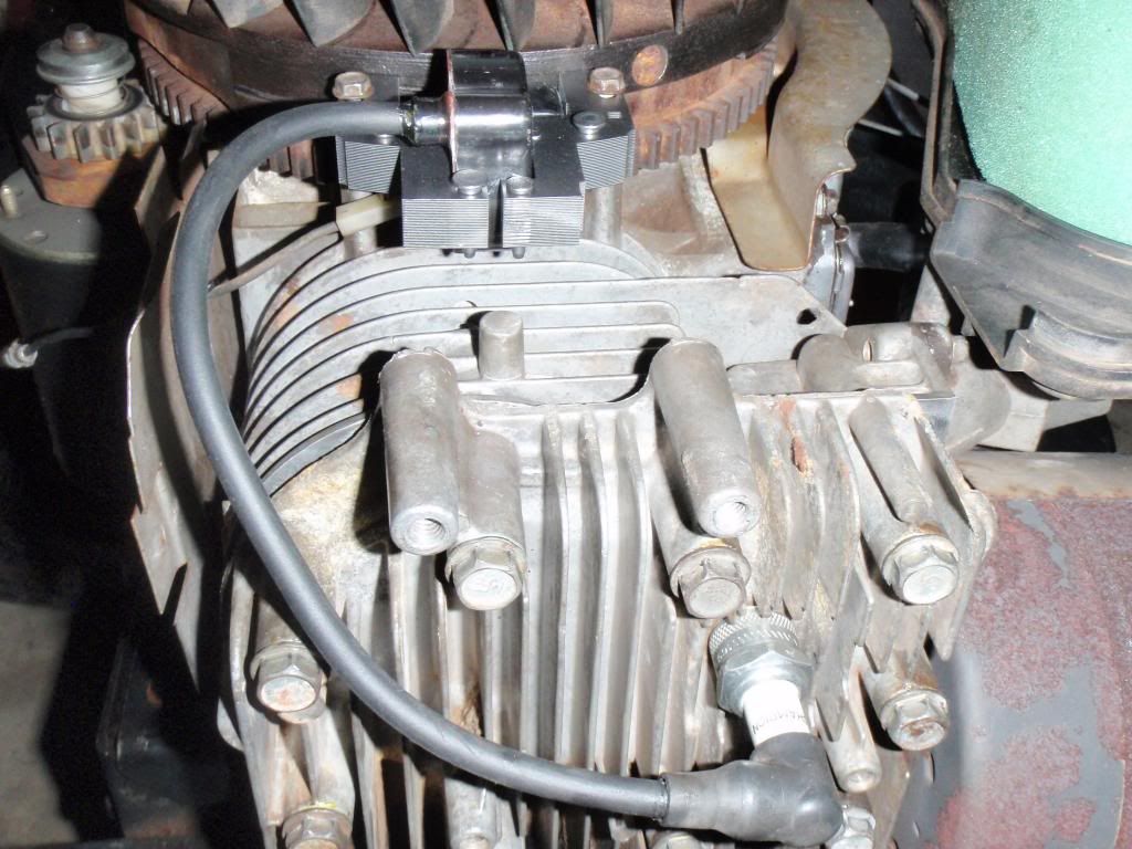

Searching for ideas, I ran across this article from B&S FAQs: Briggs & Stratton Ignition System Testing | Small Engine Repair FAQ. The coil information intrigued me. I knew coils could be too weak to produce a spark under compression, but I never ran across one.
So the next morning I ran through the checks. First check was to get a resistance reading on the secondary coil. My reading of 4.5K ohms was on the high end of tolerance, but still within tolerance. Next test was to do a spark gap test. I don't have a spark gap tester, but I ran across a YouTube where a guy made his own from a spark plug.
He made one by cutting off the stem of a spark plug. I did kinda the same thing, except I just opened the gap to 0.166 inches like the B&S article claimed. The coil would produce a spark, but it was weak and inconsistent. In other words, it didn't always spark when it should have. At this point I didn't know if the result was because of my home made spark tester or other reasons, but I went on a leap of faith and bought a new coil.
Installed the new coil and hooked up the home made spark tester. The new coil had no problem throwing an arc 0.166 inches. Turned the ignition key and BAM it started first try. It ran up and down all RPM ranges no sweat. Also was able to shut it off and restart repeatedly. But as a true test, I took it out and mowed about an acre of tall grass with no problems and it ran like a champ all day.
So the coil was the last part giving me grief. By the way, the new coil also measured 4.5K ohms on the secondary coil. So a reading within tolerance doesn't necessarily mean you have a good coil. Follow up with a spark test.
And in case you are wondering, here is a live action photo.
