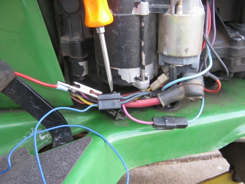

I checked the ground wires under the frame near the right front wheel. With the key on and motor not running I turned on the PTO switch and listened, but did not hear a click. I disconnected the PTO wires from the clip (the one located under the starter on top of where the wires go through the body and below) and first tested with a test light to make sure it was getting power. I used a multi-meter to find I was getting 12.4 volts between the + and - of the battery. Then I tested the voltage at the end of the clip and found it to be 12.4, so I knew everything was OK (switch, safety switches, etc) all the way down to where the wire clips together.
I then used two jumper wires straight from the battery to the end of the clip that goes to the PTO. I tested the wires with a test light to make sure they were making contact. When connected the PTO made no clicking noise and it could be easily turned by hand in all situations.

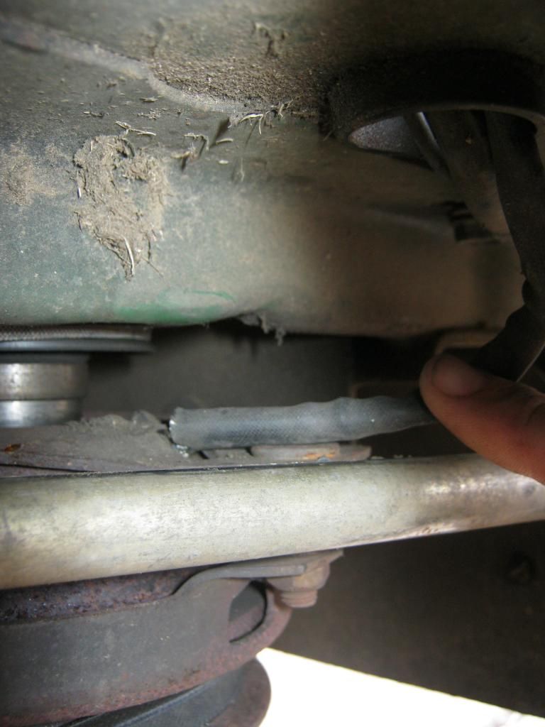

Here are the wires that go from the clip to the PTO, and you can also see just a small part of where the ground wire attaches to the frame.
Does this pretty much confirm that my PTO is bad? I've seen something about an "air gap" mentioned, but I don't understand what that is referring to. Would I have to replace the entire PTO or can it or part of it be rebuilt? Is there anything else to check?

Check the wires that go into the clutch. Often, one of them breaks just before it enters the clutch coil. The air gap is adjusted by those 3 nuts on the clutch. If the gap is too large (happens over time), the clutch can't pull in. If you can help the clutch pull in by applying voltage and then lifting the clutch plate with a screwdriver, then the clutch is good and needs adjusting. How many ohms do you measure between the clutch wires?
