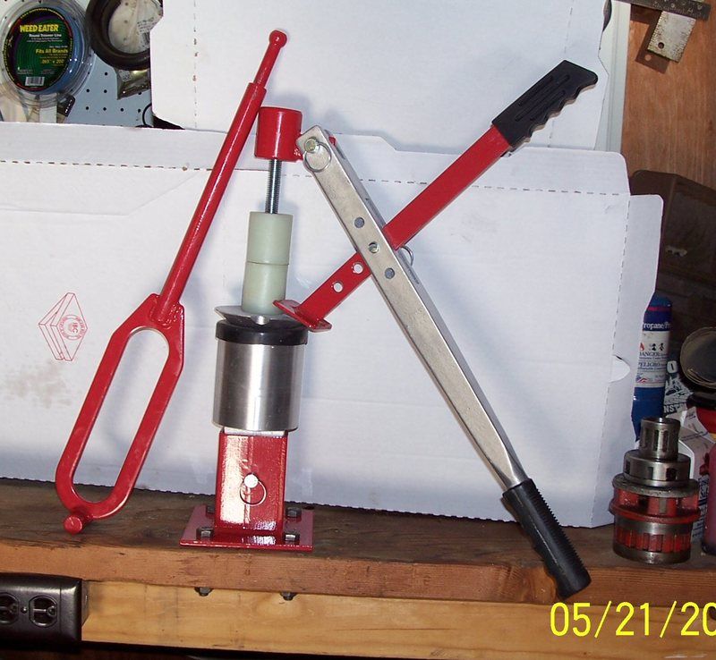

Machine arrived today and that thing is a dream, mostly I suppose from being able to bolt the whole thing down.
Removed tire with no trouble at all, mounted the new one, I didn't use the tube I bought.
Struggled getting the last bead on until I remembered to push the opposite side down to where the rim is smaller. That handle went around like going through butter...plop...DONE. Aired it up, happy as a clam. Don't forget soap!
I don't know if it is worth $40, less than $30 from a store with coupon, but it sure was easy after watching a few videos. Here is one of the better ones I found showing how easy it is:
https://www.youtube.com/watch?v=QKIgIXuziXg
Thanks everyone, sure appreciated the help. :

I don't know if it is worth $40,...
In terms of the raw materials, not even close. That bar with the shaped end IS the key along with the solid mounting of the wheel. If a person had a substantial workbench AND could shape a bar with the proper end then making a tire changer is easy. Even just mounting a steel pipe with a plate on top in a large chunk of concrete buried in the yard and a properly sized through-bolt to attach the wheel would make changing a tire much easier. The major trick is to mount that tire/wheel securely so that you are not fighting it moving all around at the same time that you are fighting the bead.
I've thought about making a changer with about a 12 inch square piece of steel on the bottom of a vertical pipe and then setting concrete anchors in the floor of my garage. This would allow for me to bolt the pipe in place when I wanted/needed to change a tire and still remove the pipe when not needed. Since I change tires so seldom I doubt that I would ever follow through on the thought.
Absolutely. If a person had a welder and maybe torch like you do you could make one rather easy I'd guess. I have neither so this worked for me. If you have a HF close by and a 20% off coupon from the internet it would be $32 + tax.
Here's a picture I took for my crabass brother. When done you can break it down in 5 minutes and store it away.
