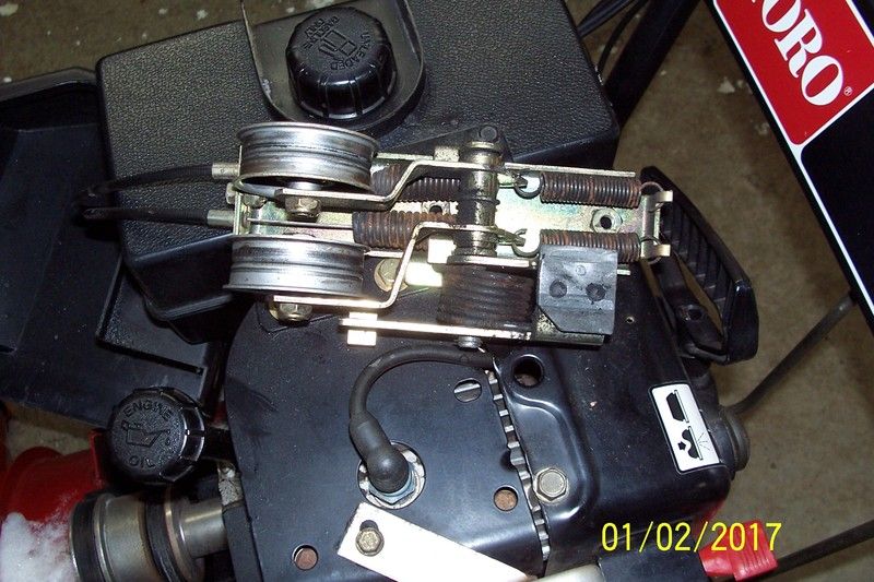

Blowing for an hour then the handle that propels the auger suddenly got real weak, noticed it wasn't blowing snow. With it empty the auger will turn.
Took the belt cover off and everything looks okay except the belts are probably looser than they should be, haven't adjusted them in the 20 years I've owned it.

With the handle engaged the pulley seems to go all the way to the stop so I'd guess the cable is okay:

So, could the belt suddenly get that loose or do I have a spring broke somewhere that I can't see?

Soon as it warms up a little I'll go take another look. The belt riding low and not lined up (doesn't look right to me) is actually the belt for the wheels.

With the handle engaged the pulley seems to go all the way to the stop so I'd guess the cable is okay...
I guess not. While bending down I looked up and noticed strands under the lever, only one strand still holding. I guess that is why it suddenly felt weak. While trying to adjust the belt a little the last strand let go.
Luckily Toro has a free downloadable service manual and parts list, all I had was the Operator's Manual. Ordered me a new cable and belt, hope that will do it.
The first thing to check is the main impeller bearing pull up on the big auger pulley to see if there is any play in the bearing. Next check if the impeller shear bolts are broken let us know.
Shear pins are good and all the pulleys seem tight, no play at all. The manual says the spring on the cable should have .010 gap in the middle... I didn't have any. Sure wish I had know all it takes is a half inch wrench on the cable to adjust the belt tension, nothing to it.

Is there any way to get the impeller cable off without taking out the center pin and having everything come loose?
About the belt. It was at rest when I took the picture and I must have bumped it while checking the pulleys, with a little tension on it it tracks straight as an arrow.
