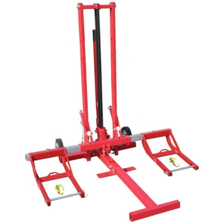

I use something similar to this:
The one we have has a hand crank similar to what you would find on a boat trailer with a strap to raise the stirrups.
Many of our bigger front mount decks have a built in power lift for the deck. The mid mounts I use this tool as well as any other riding mower.
For some of the really big mid mounts, I fire up the fork lift
However you come up with to do it, you should lift the frame of the mower so the deck still hangs, do not lift on the deck specifically as you can cause damage to the mounting.
