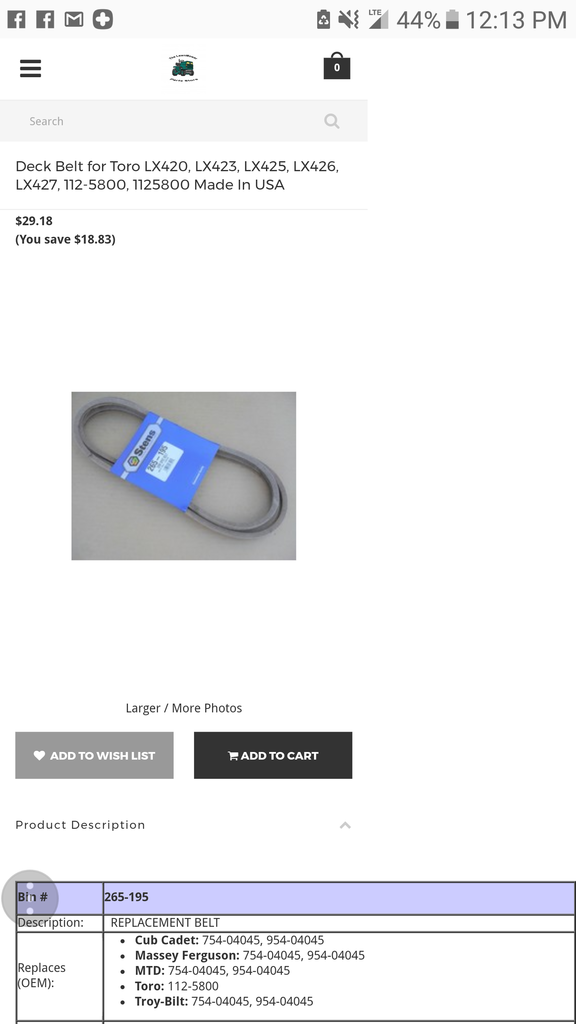

So these are a few pictures to better explain it. The one I got is a club cadet belt for 2 tractors one of which is 95404045
I found an oem online that is for a number of tractors, including my tractor and club cadet 95404045. So they would be the same belt then as far as I can tell.

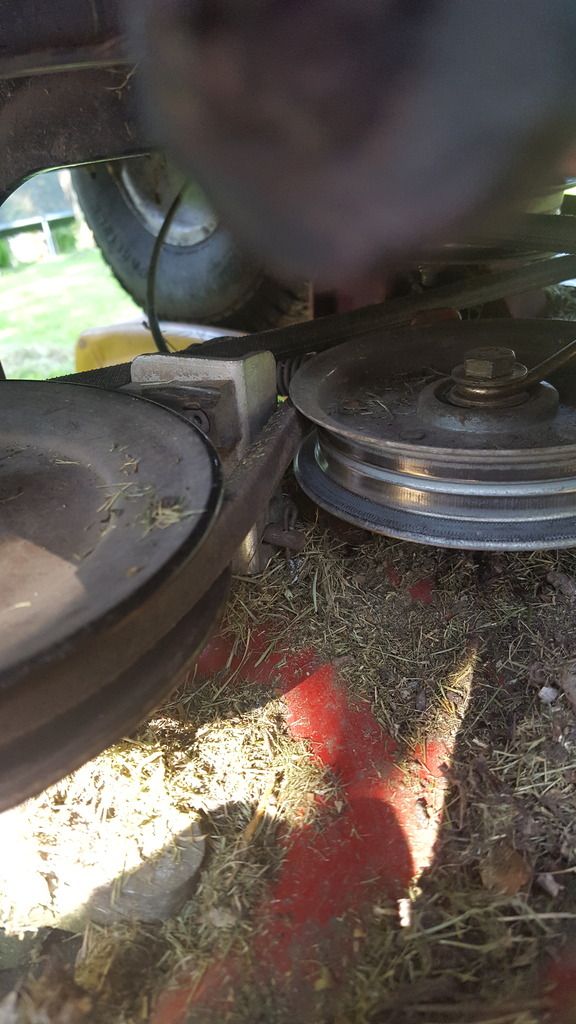

Ok so i went ahead and changed the belt. Trying to get the nerve to start it up and engage the blades to see what happens. Im worried though because 2 things youll see in the pictures below. 1. Despite the fact that it's 3/4 of an inch shorter than what it should be the belt seems way too loose up by the engine pulley, that much slack cant be normal can it? I feel like it would regularly just fall off the pulleys when engaging and disengaging. 2. That metal bracket in the other picture is touching the belt, not by much but it is touching the belt (That photo is when the pto is engaged) when its not engaged its not even close to touching it but when you engage it moves the other pulley bringing the belt in contact with the metal bracket. The metal bracket does seem to be slightly bent in and blackened where the belt contacts the bracket, like it should be there or has been like that for a while. Wouldn't that damage the belt? That doesn't seem right to me. Maybe I'll get the courage to start it up and just see what happens before I get an answer...thanks for the responses so far guys, love this site.

Many years ago I had a Dynamark lawn tractor. It also had a manual PTO engagement. The belt needs to be loose when the PTO is disngaged, otherwise the mower deck would always be engaged, albeit slightly. On my Dynamark, there were two metal "rods" that were parallel to the motor shaft (perpendicular to the belt), one on each side of the motor pulley. The rods were adjustable and, as I recall, sat approximately 1/2 inch or so from the pulley. The purpose of the rods was to prevent the belt from falling off the motor pulley when the PTO was disengaged. I assume that your Toro has something similar.
With the engine not running and the PTO engaged, is the belt tight against the pulleys? If so, then it probably will work correctly. One thing to check before you start the engine. With the engine off and the PTO disengaged, see if the blades turn without too much resistance. As Pete pointed out, there could be grass wrapped around the blade shafts.

Decided to start it up, just got finished cutting what i couldn't cut the other night, it sounds and runs beautiful. No problems at all and cut a decent bit of grass. No smoke, no burning rubber smell, no vibration, no noise. She's back to her previous beauty.
I dont have an owner's manual since its used but there is a downloadable one online i bookmarked for future use.
I did check before starting it up and the belt was tight with the pto engaged, just seemed a little too loose when it wasnt engaged but with all the guards and brackets that hold it on after thinking about it I'm sure it wont come off, I was just nervous when i first put it on.
