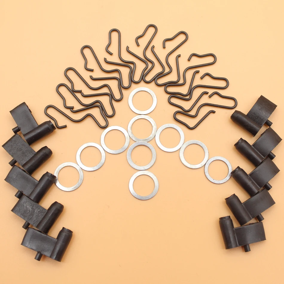

Stihl products are not very DIY Friendly; but I think the recoil starter depends on a couple spring loaded pawls or dog legs and one of them may have become loose and is flopping around inside the housing:
Maybe you'll find a kindly Stihl Dealer who'll sell you the dog you need; even though he,s not supposed to do that . . . . or you can look for "one" or "two" on-line, once you know exactly what you're looking for.

Are any of the parts in your pic right behind the fan? The fan isn't moving out and back, but something behind it is moving when I turn it on its side....

The parts he's showing are part of the pull start. # 7, 8 and 9.

Those are recoil starter parts. They would be around the starter rope.............. Just like Pete showed you.
