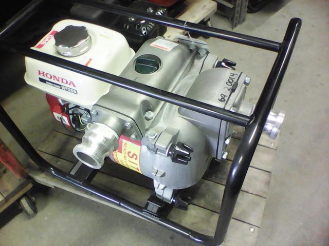

Here's a picture of the engine driven pump they have for rent. It would come with 25-foot inlet hose. But as far as the discharge I'd want to be able to hook a garden size hose to it somehow that would then connect to my pressure washer. So not sure how I'd be able to accomplish that. any comments/ideas appreciated.

No....... that is way to big. I don't think you could throttle that down low enough.
Did you tell the equipment rental place what you were going to use the pump for ?
You need a small pump. The link is just an example and even then it may be too powerful.
Gas powered pump
Yes.
And I don't think they rent a small pump size as per the example posted. They didn't mention such. If I wanted a pump like that example I'd have to buy it, from somewhere. Heck.

I didn't figure they rented a smaller gas powered pump. I was just curious if they actually said that pump was good for what you are doing.
Ultimately you could use that 2" pump but you'd need to make an adapter to go 3/4". On top of that..... I'd imagine a gauge would be required and a way to bleed off too high pressure from that pump.
They said they couldn't tell me if their 2" pump would be good for what I am doing, and stated they would question whether if the intake hose was running uphill on much of a slope toward the pressure washer if it would provide enough pressure to the pressure washer. That's what they said. But I would tend to agree instead with Pete here that that pump is probably way overkill for the situation. I thought about the idea of an adapter too, to connect the discharge from that pump to the regular garden hose which would then feed the pressure washer, which I suppose might be feasible but then to have to install a gauge to monitor and bleed off whatever would be too high pressure would be more involved/complicated then I'm prepared to deal with. So I'll probably nix the idea of using that 2" pump after all.

It works! I did a test/trial run. I scrounged up a couple of hose barb fittings in my old junk, metal ones but otherwise pretty much the same as what StanStr posted in post #29 here. Installed one down by the bottom of a big 'ol plastic trash can we had sitting around, and the other at the end of the 4' long chunk of old 3/4" garden hose I also scrounged. Put the trash can up on a couple of saw horses and put the pressure washer right there below. Hooked up the hose between the trash can and the pressure washer and filled up the trash can with water. Fired up the pressure washer, skeptical it would work very well. But it worked like a charm. And the pressure washer didn't even "cavitate" or anything. Operated fine, with no issues. Quite obviously was adequate ample flow with this setup. As long as I keep the trash can reasonably full of water i can pressure wash like this with no problem. Thanks!

Great, just make sure you keep the trash can full, let it overflow but not on to the pressure washer, and you should be in business.

For others' reference, a common way to use an oversized pump is to build in a bypass discharge circuit. You can use the gas pump with 2" outlet, but plumb up a 2" tee adapter with two outputs and a pressure gauge. One output goes to your pressure washer, the other output goes through a ball valve and back to the stream. You fire up the pump then adjust the position of the bypass ball valve which discharges part of the excess flow back to the stream until you maintain the desired pressure at the manifold. This method keeps both machines operating without starving or over pressuring.
