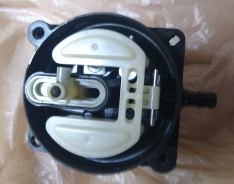

Below is a pic of the underside of the carb (from within the bowl looking up).

Turn the part in the picture down and blow in the fuel inlet. If you can't get air through it the float valve is either stuck or plugged.
Don't be sticking stuff down the inlet tube. You might damage something.

marbobj I tried blowing into the inlet -- out the right side of the photo -- it is definitely blocked
It looks like the white horseshoe-shaped thing is the float valve and that it may come off if I slide out the pin (also on the right side of the photo), but though the pin would slide, I thought I'd ask here before taking it apart. The horseshoe-shaped bit moves like a float valve should, though it doesn't move very much, but no mater how it is positioned, I can't blow air through the inlet.

With the float (white horse shoe shaped thing) hanging down, you should be able to blow through the inlet. That's the path gas takes to get into the float bowl to run the engine.

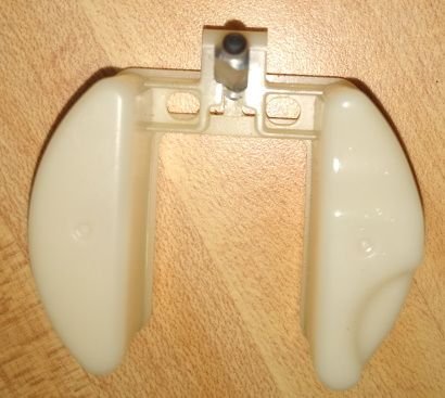

I could not blow through the inlet with the float valve hanging down, so I removed the pin that was acting as its hinge and the only thing I saw holding it on.
I then tried blowing again to no avail, but could see what looks likes a stopper that I theorized ws pushed by the float to stop the flow. It was definitely stuck, so I tried a little vinegar on a Q-Tip before just pulling it out.
I can now blow through the inlet and there's some goo on the frame of the stopper that I believe made it stuck -- possibly from using gas with ethanol. Though again, it was a cheap, knock-off carburetor which is no longer being sold
I have the pin-like stopper soaking in vinegar while I post this reply. My plan is to clean it and the hole it uses, then try putting the thing back together. If it works, I'll post another pic.

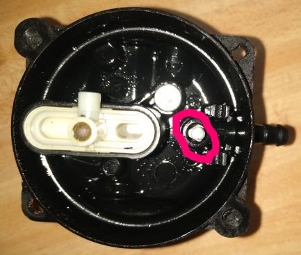

I'm not going to put the mower back together until in the morning, but now that I have the carb back together, I am pretty confident it will work. The float now hangs down much further than it did before and when it is hanging down, I can easily blow through the inlet. Everything seems clear.
For anyone interested with a similar carburetor, the pic above was the all together underside with the bowl removed,
The pin or bolt-like stopper is circled in red on the following pic. It is under the (removed) horseshoe float
To put it back together and to keep in mind when taking it off, the head of mine slid into a track on the float which was easier to put together before putting the float back in place.

Tryagain, I ran into a carb similar to yours that not only had a steel pin that acted to stop the fuel flow, but a composite material washer that acted as a valve seat for the needle on the tip of the pin. It had swollen up (probably from ethanol) to the point where I could not set the float to the proper height to allow enough fuel into the bowl. You sound like you are past that now, and I get it about the 100 bucks to drop off a mower and the 6 week wait. If you make friends at a few of those places though, sometimes they don't mind sharing some captive information that they may have gotten from a Manufacturers service bulletin that you would have never seen. I put a new cylinder head on a car that was long out of warranty that the manufacturer would have paid for had I brought it in to the dealer where I bought it. Just saying, keep your options open.
