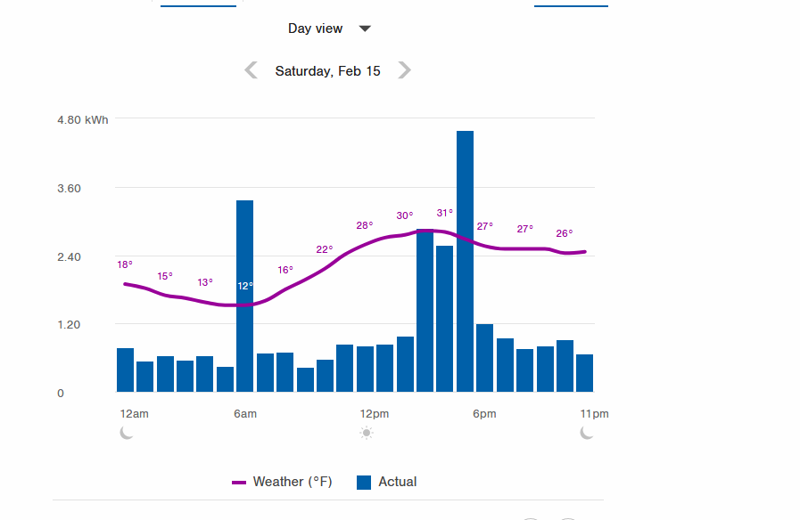

just came to me how to figure out my watts needed. i picked a day in FEB on a weekend. highest usage time for heat. looks like i barely got to 5000 watts even with the boiler running. i had no clue how much juice the boiler used
also now that i think about it, the hot tub going on 2x a day for 30 min is in that chart around 6 am and 6pm and of course that woudl be turned off during the outage. so the 2 spikes are the hot tub
really makes me wanna lean toward the interlock. assuming i'm reading the chart right i barely used 4000 watts at anyone time during the day
