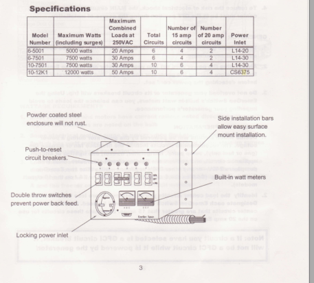

Think about this. You want a generator for emergency use during a power outage. You'll be inside your house, most likely with windows closed. The generator will be outside, not under or near a window or vent, at least 15 to 20 feet away. Noise will not be a problem. Those inverter generators are meant for camp grounds and situations where you may be running them for a very extended length of time. They also cost by at least a 1/3 more and go up in price as you need more power rating.
You will not want to use extension cords running from the generator to the house. You will or should use an Interlock or transfer switch. That will be integral with you existing circuit box. This is code!

Your biggest decision, do you want a whole house automatic system, one that kicks on automatically?
Do you want a nearly whole house system, one that has a transfer panel so you can run different circuts in the house?
Or do you want a small system that runs select items through extension cords?

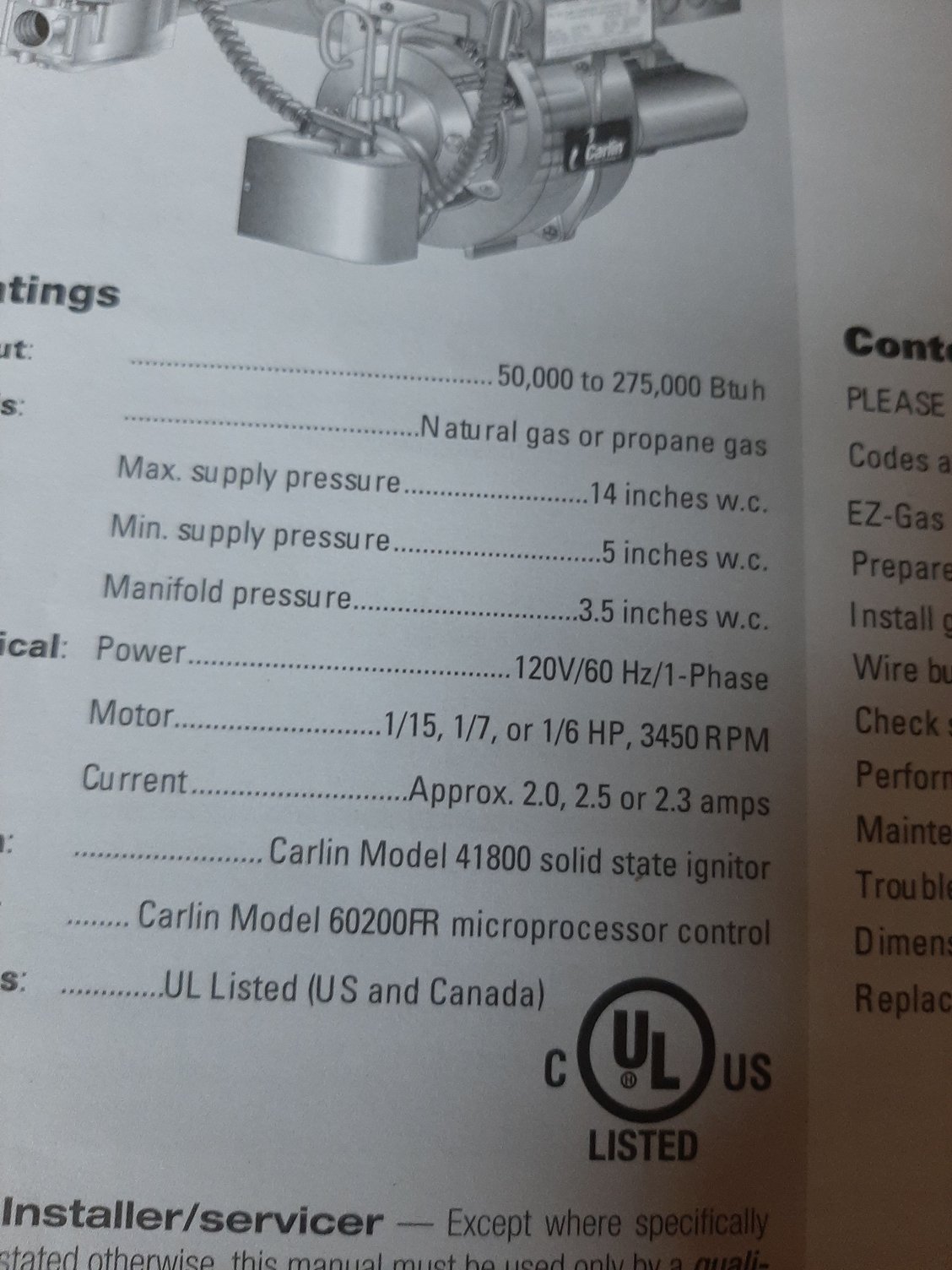

Followup question:
(Dont mean to hijack the thread. Remove if necessary)
How sensitive are newer furnaces/boilers with spark ignition (no pilot light)?
I replaced my old natural gas boiler with a Weil McLain boiler with electronic spark ignition.
I have a 3300W generator which would easily run my old boiler. Biggest current draw was the circulator.
But since the new boiler is electronic spark (no pilot light) do I dare use my generator?
A 2000W invertor type would be ideal, but, well, I already have a generator.
Or, is there some circuitry I could add in-line to smooth my generator output?
And this is why I stay away from electronic ignition systems. We've had pilot lights for at least 50 years or more and never a problem.
I would call the maker and the installers and ask how your warranty would be affected if while using a generator, the ignition goes bad.

Basically any generator can be be connected to a transfer switch or an interlock. However, once it's sized to a particular size generator, you can't increase the generator size, due to the plug configuration (30 amp vs 40 amp). You would then need to change the female outlet attached to outside of home and the wiring (3 wire and/or 4 wire depending) to match the new or bigger generator.
So if you're going to go with a gasoline powered generator to supplement power during an outage, then go with nothing less than 30 amp plugs and minimum of 6300 watts peak and 5000 watt continuous running.

ok good to know. some of the units specifically say transfer ready and have special outlets where the one i want is just the normal 20 amp outlets. since theres only one left in stock i may buy it and i can return unopened in 30 days while i do more research. waiting for 2 guys to call me back to do estimates on transfer switches.

This is from mine that I installed back in 2006. It's Connecticut Electric brand. Not sure if it's still made. But they provided a video to DIY. Very easy. But here are the specs. Not sure if it's still to code.

ive looked at every piece of paper and on the unit but i cannot find watts for my boiler. would the burner be the most juice used by the boiler? i know there are lotta circulators and my computer board but those arent as much as the burner i assume? its only 122K btu, my old one was 250! used tons of oil

I would think the pump would be the item that would need peak starting wattage and use the most running wattage.

three 1/25 HP .71 amp pumps are attached. taco 007-f5
https://www.supplyhouse.com/Taco-007...5-HP-1983000-p
so lets say 2.5 amps to be safe
2.3 is max amps on the burner i have so can round up to 5 amps total of juice used.
no clue what surge would be though.
