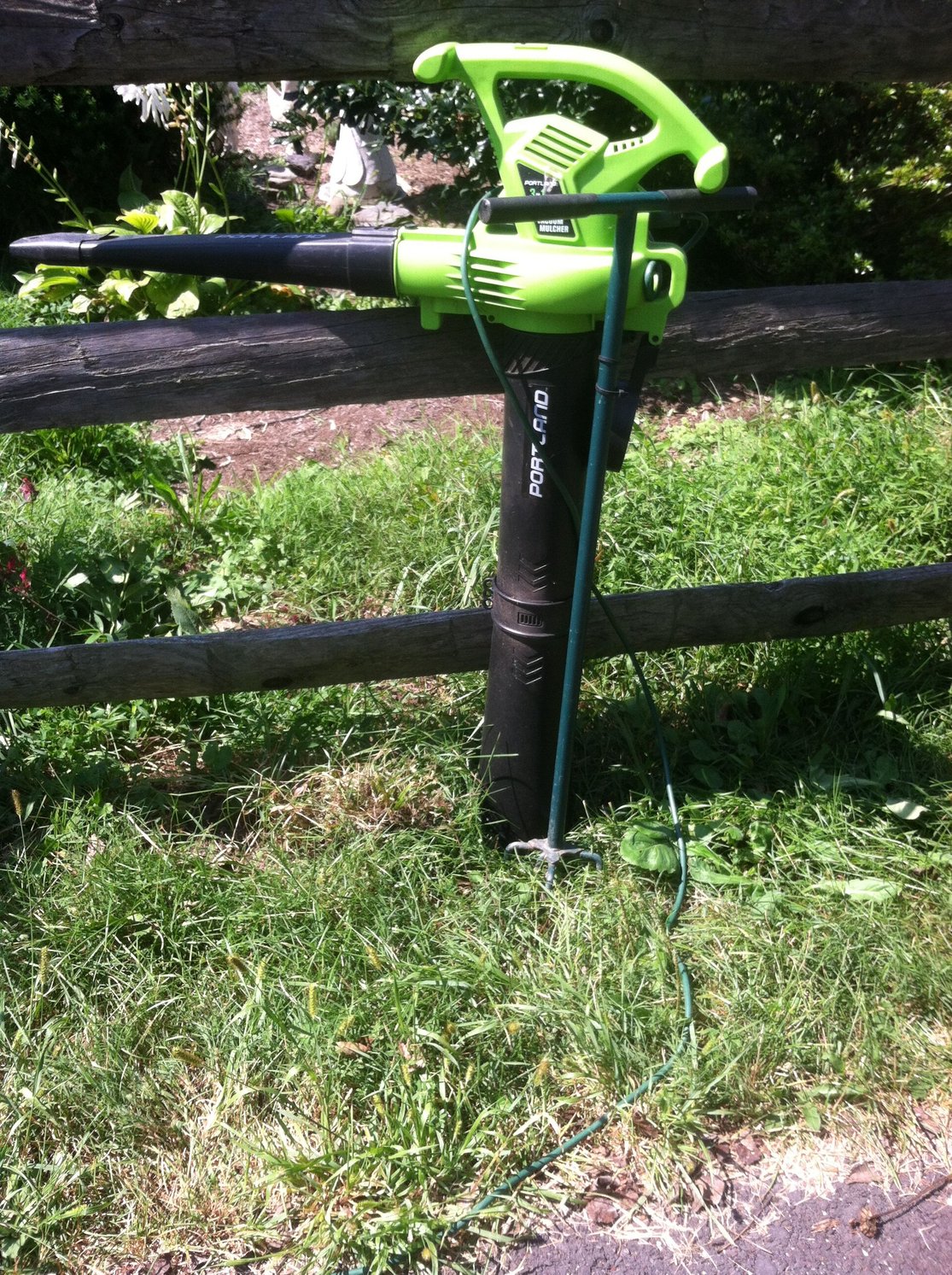

However, I've found the smaller blower / leaf vacuum-shredder works nicely for mulching leaves into compost. I like that the leaf uses a vacuum to lift the leaves, this keeps it from sucking up dirt and stones. You can leave the blower nozzle on shoot shredded material out, instead of collecting it in a bag.
Here it is propped up with a garden aerator, removing yellowjackets from a nest; BUT you could lay it horizontally, just feed stalks of hay into the vacuum tube and blow shredded food into a burlap bag.
It grinds up hay for my horse with no teeth
VERIFIED BUYER- Tim- August 27, 2019However, I've found the smaller blower / leaf vacuum-shredder works nicely for mulching leaves into compost. I like that the leaf uses a vacuum to lift the leaves, this keeps it from sucking up dirt and stones. You can leave the blower nozzle on shoot shredded material out, instead of collecting it in a bag.
