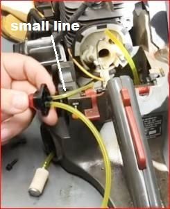

Not a specialist in small engine repairs and this should have been a no brainer.
My fathers approx 20 year old chainsaw kept stalling. It may run for a few minutes and stop. I checked the primer bulb and it was dry. When pressed I could air. I opened the tank and found the filter rolling around in the bottom of the tank. I cut back a little line and reconnected it. The saw was running again and then stopped. I opened the tank back up and the filter wasn't connected. The line was split. Ok..... figured I'd change the line.
I took the saw apart and found all the lines to be worn out from the age. There are three fuel lines. One from the tank to the primer. One from the primer to the carb. One from the carb back to the tank. The two to the primer were the same size. The other line was smaller. If you've ever changed fuel lines into a tank you know what a headache it is.
I replaced all the lines. When I pressed the primer a small amount of fuel came up the line. When pressed a second time it stuck in and pushed the fuel back to the tank. WTF. I took the primer bulb out and it is labeled carb and tank. I had the hoses in the right locations. I decided to swap them. Now the primer fills up with gas and the line back to the carb is full of fuel..... just like it's supposed to be.
It now starts but won't stay running.
I put it aside for today and will look at it again tomorrow.
Any ideas and what exactly does the small line from the carb back to the tank do ?
I thought it was a vent but the end is in gas.
Thanks.

The line from the fuel filter in the tank goes directly through the small hole in the tank to the top nipple on the carb thus giving the carb a constant supply of fuel when running. The primer bulb is used only for "priming" and does not play a part in the fuel flow after that function. The bottom nipple on then carb then goes back to the nipple on the primer bulb which is clearly marked "Carb". The above connections are made with the smaller diameter tubing. From the primer bulb, marked "Tank", the larger diameter tubing is routed to the large hole in the tank. The tubing goes into the tank only 1/2 to 3/4 inch. As far as getting the tubing through the holes in the tank, cutting the tubing at a slant. But no matter what you do it is still a witch. Be patient, use some Vaseline and avoid the temptation to get out the drill and drilling the hole to a larger size.

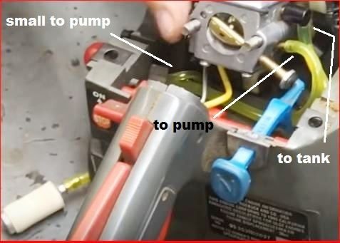

I just learned something I wasn't aware of.... this is not a primer bulb..... it's a purge bulb.
It draws gas thru the carb and back to the tank.
Fuel flow = from the filter to the top of the carb, out the bottom of the carb to the primer bulb, then out the primer bulb back to the tank (no filter on that line).
Changing lines isn't too hard. Pull out the line with the filter from inside the tank. From the carb side of the tank cut the end of the new line at a long angle and push that through to inside the tank. You can usually feel that end and if you have it cut thin enough you can catch it with pliers and pull enough through to clip the end and stick the filter on. Make sure you have that end long enough to lay the filter on the bottom of the tank.
Do the other line the same way.
When you hook up the primer, make sure the suction side is coming from the carburetor and the out bound side is going toward the tank (no filter)

Small line goes with the filter then to the top of the carb.
Clip the end square and hold the end in hot water for a minute. It'll stretch over the filter.
Yep, small line has the filter and suplies the carb and the filter should be able to lay on the bottom of the tank. The large line goes from the pressure side of the primer back to the tank.

Here ya go. A way to check if you have it connected right or not:
https://www.youtube.com/watch?v=uCC1qO75zDk
You may question if your check valve is working properly.
I think this will get you to where you want to be. Forget small and large lines, just work on the routing and go from there.

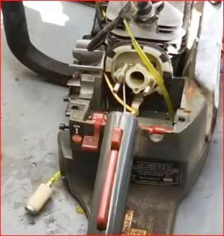

Yes.... I have two different size lines. The one near the fill is small and the other is the larger one.
This is from that video I linked to above.
Filter on large line
small line on purge bulb
My carb has two brass connection pins.... not that right angle black piece.
It won't affect operation if the filter is connected to the larger line as long as that line is long enough to hit the bottom of the tank and is connected to the correct fitting on the carb and the other lines are connected to the right ports and all fit snugly.
Yeah, that's a different routing of the small line. I don't know why they have the two different size lines on any of them. It's pretty common, but it seems more so on chainsaws. The filter would fit a lot easier on the larger line but the upper brass fitting is usually sized for the smaller line. It couldn't be to just distinguish one line routing from the other. There's a lot of other ways to do that. Interesting.
The one thing I've noticed over the years there's a lot of difference in the size of the smaller line. Not only the O D, but the I D has bounced around. I'd guess that comes in with the source.

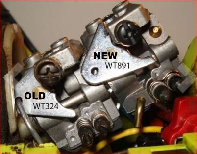

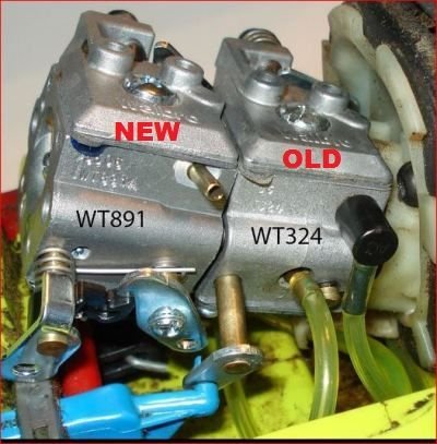

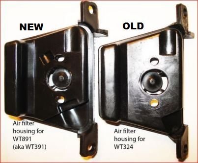

My Sears saw is a 358.360460
The OEM carb would have been 545081885.
The new replacements aren't the same. Apparently the filter box needs to be modified or buy the carb and filter box as a kit. The lines are on opposite sides of the carb.
In looking around.... I found eReplacement to offer the kit. About $30 with shipping.
eReplacement carb
Any thoughts ? The rebuild kit is inexpensive but is it worth the time to rebuild it ?
I'm fairly certain the diaphragm is shot by the way it's acting.
Thanks N.E. Wolf for the pictures.
eReplacement carb
