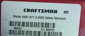

I'm out of ideas. I replaced the friction wheel ring and my drive belt on a Craftsman snow blower. When I tested the snow blower today it wont drive. It starts to drive but when I depress the drive lever further down it wont go anywhere. The friction plate spins but when I depress the drive lever all the way and the friction wheel makes contact with it, the friction plate stops spinning. The parts I replaced are all OEM. In the video the drive shaft rod isn't attached but I get the same behavior if I attach it. .
Here's a video of what happens. https://photos.app.goo.gl/MvdzRFp5SQFzKiB68
