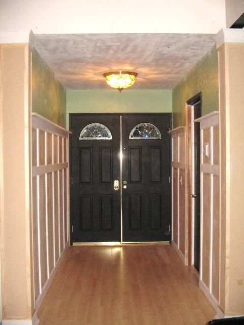

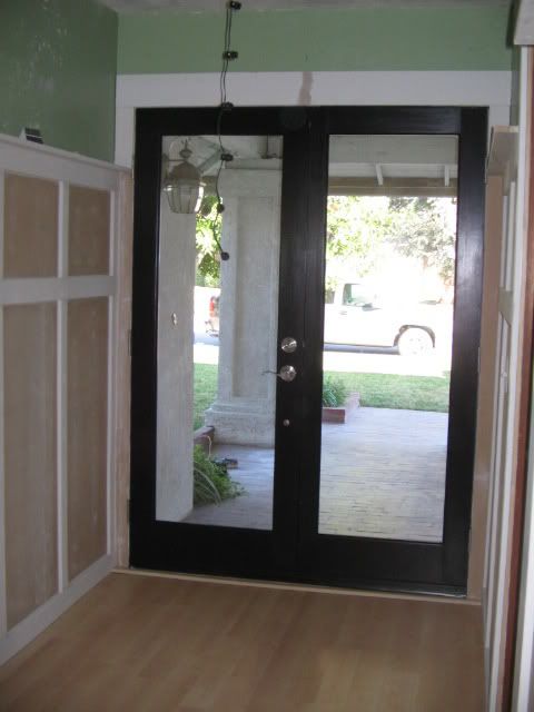

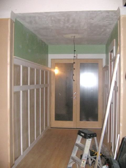

Old doors (before):
New doors (prior to painting):
New doors (after painting-interior):
New doors (after painting-exterior):
