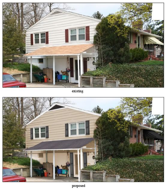

Sorry if I was a little confusing in my line of questioning.
Really, I am asking several different questions. Concerning TSP, my question was regarding the general cleaning of the brick surface and mortar, for appearance sake, and then for the cleaning of the aluminum siding prior to painting.
My line of thinking is as that I will clean the entire house with TSP to prep for painting. Asides for the paint drips, the brick just looks old and dirty. Ideally, I do not want to paint the brick, though after painting the hole house, I do not want the front to look ****ty in comparison with the rest of the house. if I can get the brick fairly clean, then I will try and tackle the overspray.
So, after painting the 3 aluminum sides, I (really my wife) will decide whether or not to paint the front brick.
Here is the existing vs. proposed.
And here is the Wagner PaintCrew 660.

You won't remove overspray from brick with TSP.
As for general brick cleaning, there are commercial brick cleaners on the market made specifically for brick cleaning which work very well.
I am not sure what type of detergent tank you are using, but most chemical injectors will dilute the cleaning solution greatly. You usually need to use a concentrated cleaning solution so that it will not be too diluted coming down stream from the chemical injector.
The specs on the sprayer look OK: You should use a 415 or 517 tip with about 2000 - 2500 psi with most exterior latex paints. Be sure you are aware of how to use the airless before doing so. Familiarize yourself with how to release the pressure, how to unclog a clogged tip properly, and know that accidental injection from an airless sprayer is a serious injury that you must be cautious of.
Emulsabond is tricky to use in a one coat spray application, don't use it if you don't need to (i.e. if there is no chalk present).
You don't need a primer on aluminum siding that is clean, and previously painted in a flat finish. You will need to prime if the paint is glossy.
You will know if the previous paint is adhering well once you pressure wash the siding, if not, it will blast the weakly adhering paint off.
As you are probably aware of, there is a lot of direct masking off required when spraying aluminum siding. You will also need to be careful of paint drifting on to objects down wind (including the neighbors house and car etc...)
Flat paint is easy to use and spray on aluminum siding. Sheen paints require a little more spraying skill to avoid lapping and fogging.
