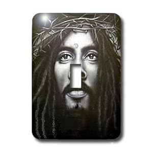

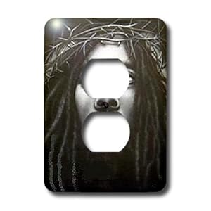

hey what about these... they're not too tacky are they?

Hmmm, I dont think they are "tacky", no. :P :P :P (lolololol)
