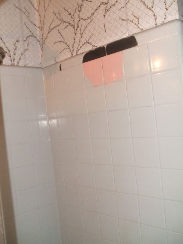

I bought an apartment last year that has old glazed tiles in the bathroom which are now peeling and flaking. I would like to just rub off the rest somehow and then re-grout.
Is there a product I can buy to remove the glaze? Any tips?

Can you upload a couple pictures?

I have since removed the wallpaper and painted, and reglazed the tub. The peeling has increased further since this picture.

You sure the tiles weren't painted and the paint is what's coming off?

I can't be too sure, I'm not an expert in these matters, but I did have a tub glazing guy come to re-glaze the tub (it was peeling too) and he removed the 'glaze' from it first. He offered to remove it from my tiles too for an extra $1,200.
It was way too much for me as I am trying to save up to re-tile/redo the bathroom altogether within a couple of years. But for now I hate the peeling paint/glaze. It's awful.

I would also think that it's a tile paint. I've had very little dealings with that type of coating and don't know much about them I'd try a paint and varnish remover on a tile or two and see how that goes. Can it be scraped off?

yes, it can scrape off if you start at a loose, peely edge. I spend half my time in the shower picking at it.
I guess I'll have to try the paint remover and update you guys. Thanks!

Does it come off in chips or more like peeling a banana?

It definitely chips! It makes for very annoying to pick at stuff because it cracks off- I can't get much of it off.

Do you have a fixed shower head or one of the ones which has a hose and comes off? If the latter, you can make a bit of a pressure washer with the shower head on a massage-type setting and that might help speed the removal.
