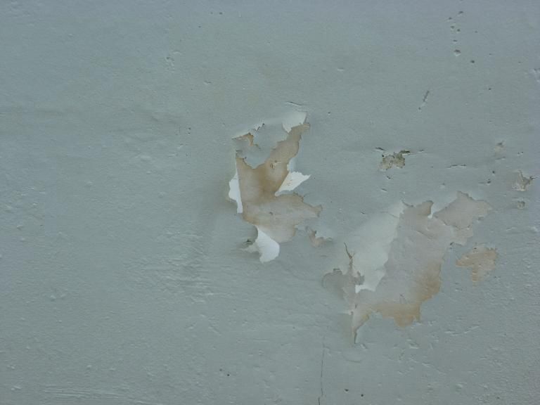

Two years ago I hired someone to paint the exterior of my house. Contract called for pressure cleaning the house to strip off old paint, 1 coat of primer, two top coats. I spec'ed Benjamin Moore Fresh Start primer and latex paint. I wasn't at the job when this went on, I was traveling on a business trip and when I came back it was done.
Three months later on the lower side of the house paint started bubbling and peeling. I can see under the new paint the old paint. Called the painter back and phone disconnected.
Now I am going to repaint and will be hiring out again. I wanted to make sure I find someone who I can depend on. House is concrete block stucco. I have some questions.

I'm concerned about why the paint peeled! The 2 mostly likely causes is either the masonry was still wet when the paint was applied or the PWing didn't remove all the chalk - paint doesn't adhere well to chalk. Whenever chalk can't all be removed you need to either spray on a masonry conditioner or add Flood's EmulsaBond to the 1st coat of latex paint [or primer]

Pics? Florida is pretty humid, so it's likely that it just wasn't dry enough to paint.
Even here in Canada, it's been humid enough for brand new block to literally 'sweat'. This was indoors as well.
If you hire again, make sure they use a moisture meter thing to check how wet the walls are. It had two little prongs that you stick in and it uses electricity to check humidity. They're pretty cheap, so if they charge you more just because of that then hire elsewhere or buy one yourself.

I used to paint in fla and have painted 100s of stucco homes there. The biggest issue with exterior paint in fla is the intense sun will both fade and deteriorate the paint. When the paint deteriorates it becomes chalky and paint will not adhere long term to chalk! The chalk must be addressed! Ideally you'd wash it all off but that isn't always feasible - that's where the masonry conditioner or EB comes into play.
Thank you all. I am not aware of the masonry conditioner or EB.

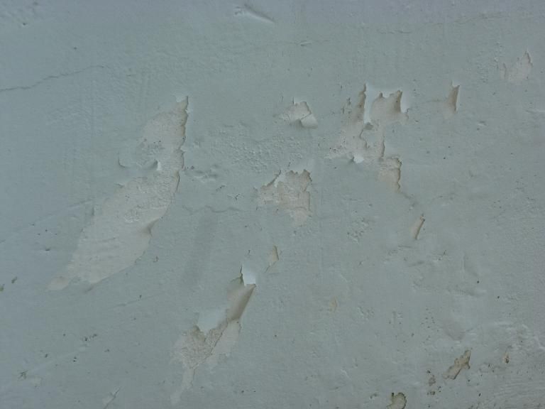

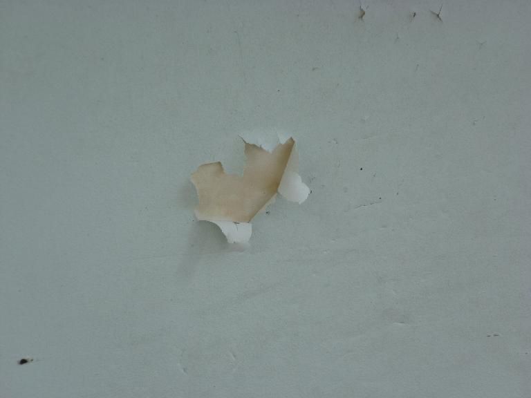

To answer your questions, at the spot where the paint peeled and exposed the old paint surface, if I touch and smear my finger on it, I can see white chalked dust on my finger. If I touch the surface of the new paint, nothing. Is this what you all mean by chalking?
Here are some pictures.
The peeling started only a few months after the house was newly painted.
Yes, the residue on your finger is chalk. It needs to be removed but that isn't always feasible [it doesn't just wash off easily] so a masonry conditioner or EmulsaBond is used to bind up the chalk. Your previous painter failed to remove or deal with the chalk.
By the way, I called a professional paint company out to have a look, and the guy told me the paint job I had was horrible, and they didn't prepare the surface well enough for new paint adhesion. He suggest I hire them to repaint, and he will use a sand blaster to sand off all the old junk.

There are different ways to blast off the old paint and they are all messy. It would be hard to garuntee a paint job that is applied over paint that might not be bonded well to the substrate. I hate to do a job like yours just for that reason. I'd probably PW, scrape and PW again and hope/pray that I got everything that might pose a problem.

Pretty much impossible for anyone to give you an answer on that question. Like Mark said, exterior painting is at least 1/2 prep and the other 1/2 painting. At this point, you have to assume that there's a lot more failing paint to come off and it's just going to be messy. No way around it.
Putting new paint, with whatever you add to it over old failing paint won't really do much of anything. Even if you can't see the paint failing yet, it's doing so.
That's why exterior painting is so labour intensive. I spend my entire spring and summer scraping, sanding, etc. with a little painting mixed in.
A few years ago, I did an average size cottage that was over 100yrs old. I removed over 50lbs of paint chips from the exterior. Let's just say it was incredibly messy.

Masonry conditioner or EB is only effective if it's applied directly to the chalk ..... well EB does have other uses too, but not with your paint issue. Paint or paint additives can't magically soak thru the existing to bond it better to the substrate. There is a chance that any paint applied over paint that was applied over chalk will peel, not the new paint but the paint underneath it. That's why we dread going over a botched up paint job and why the contractor you brought in suggested removing all the paint and starting over.
You might get lucky with removing what easily comes off, treating or removing any chalk and repainting. The problem is you can't guarantee a job like that. Pretty much all you can do is remove as much as you can afford [time and/or money] and repaint using proper prep. I hate doing a job when the quality of the end product is out of my control. Wish there was a magic coating to fix it but there isn't.
