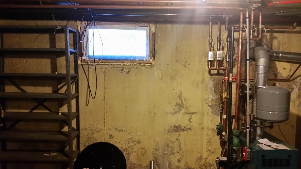

Hey all. Has anyone painted their basement walls with dry lok?
What did you use to prepare the surface? I just have non painted concrete with signs of efflorescence and very dirty.
How did the dry lok do when you paint over it? I found that 100% acrylic latex paint is recommended.
Since I can only find two colors. I want to paint my basement walls with White DryLok paint as a primer. Then paint the walls with another color on top of the drylok.

I've applied a good bit of Drylok. It's formulated to be applied over raw clean masonry. Usually taking a wire brush to the efflorescence does a good enough job getting it ready for drylok. I believe the old oil base formula does a little bit better job BUT it will stink up the house!! I haven't used the oil base formula since shortly after they came out with the latex formula. Drylok [or similar] is a must for priming raw block below grade prior to applying paint.

Waterproofing the walls on the exterior side of the foundation... Unfortunately there is not way for me to know that without digging up all around the house. Sorry man, I live in NY and my home was built in 1950.
It looks like I have a light coat of very old yellow paint so I will need to wire brush this paint off before applying the dry lok as well it looks like.
So back to my original question - What did you guys use to prep the surface with pre existing paint and efflorescense?
Drylok is formulated to be applied to bare masonry. It might adhere ok to paint but will loose most/all of it's 'waterproofing' qualities. I've always used a wire brush to remove efflorescence on interior foundation walls. I've never applied drylok over paint.

It depends on how porous the foundation wall is whether or not the drylok will do more than just paint. IF the drylok can enter and fill the pores of the block, it has a chance at stopping moisture BUT if it just lays on top, it's no better than any other paint.
Posting a pic or two might help us better evaluate what you are working with - http://www.doityourself.com/forum/el...your-post.html

You mentioned that you have a light coating of yellow paint. Since your house is 1950 this may be oil based (and lead) so the two concerns would be that incoming water vapor will blow oil paint that is not permeable off the walls, maybe that is why you see a light coating. The paint should be checked for lead if you are going to scrape, wire brush it.
Hard to tell from the pics what type of coating is on the walls but unless it's feasible to remove the majority of the existing coating - drylok won't be very effective [other than making the wall look clean]
