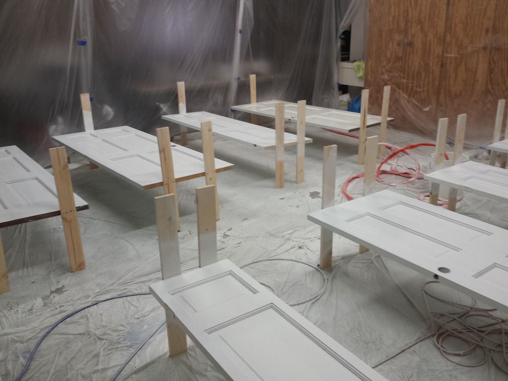

I've finally got back to this project this week
I chose to go with using an airless sprayer. Things are going pretty good but i have one issue.
Since I'm new to spraying I decided to lay the door horizontal. The issue I'm have I believe I'm getting dried over spray on the finish coat which is causing a rough texture. So far I've only done the backsides of the doors but I would like to fix this before I get started in the fronts.
Any ideas?? I'm going to try and turn down the pressure a little to see if that helps, besides that I don't know what else to do.

Any way you can stand the doors up to spray? I suspect with the door laying flat the overspray in the air is settling on the wet paint causing the roughness. How many doors are you spraying? where are you spraying them?

I'm only doing 8 doors right now. I setup a shift paint both in my garage for this project. I could stand them up but I'm afraid of getting runs or sags since this is my first time spraying.

Is there any way to exhaust the overspray out of the garage? .... be mindful of where that overspray will go! Also check and make sure there isn't any dust on the ceiling that can fall.

Really not a good way to exhaust outside. I just checked the doors again and there are only 2 doors that are pretty rough. It's the 2 that I started with to check my technique, I sprayed them and let them sit for 30 minutes before starting the rest. The other doors have a slight amount of roughness but really not enough to worry about.
Off to flip the doors and spray the fronts!

A 30 minute wait time between doors will make the overspray issue worse. If overspray falls on wet paint it can somewhat get absorbed by the paint but if the paint is tacky or almost dry it will just lay on top. You should have better results if you spray them one after another.

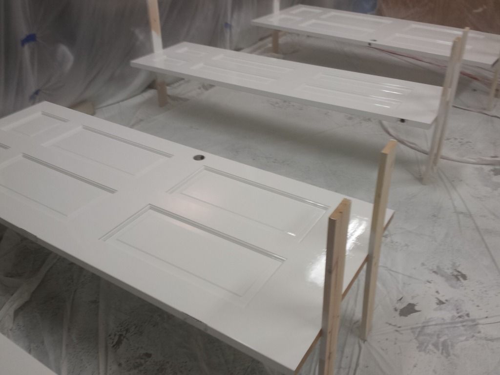

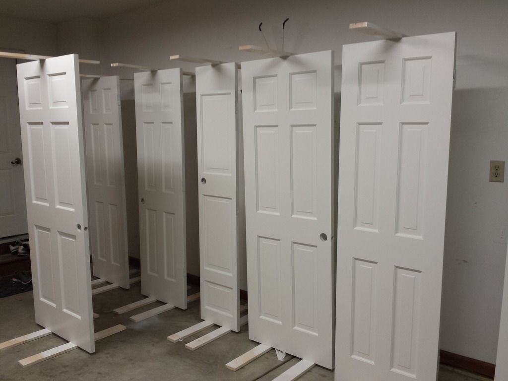

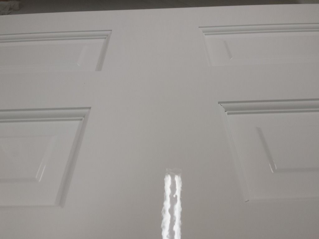

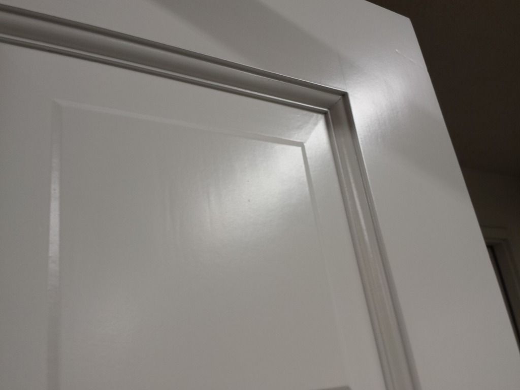

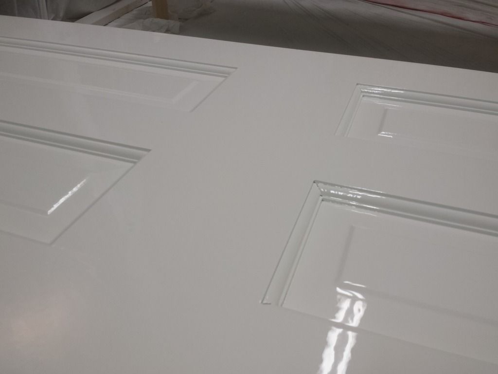

I finished the doors Sunday evening. Below are the pictures. I was planning on doing 2 light coats but ended up doing 1 heavy coat by accident. I went through about 1.5 gallons of paint on 8 doors. I think the finish looks good for a first time sprayer and 28 year old doors.
Do you think one heave coat is sufficient? The coverage is even and smooth. I took down all the plastic but the doors are still in the garage so technically I could do another coat but it would be a pain.
Actually 1 side of one door has 2 coats on it. I had some bleed through on the primer and 1st coat of paint where my wife sanded through the varnish. So I had to spot prime part of the door and do another finish coat. The only difference that I can tell between it and the single coat doors is the edges around the molding isn't as sharp.
Here are the pics, the last 2 are of the finished product.

#30
Join Date: Apr 2015
Posts: 22
Received 0 Upvotes
Yea they dried good. It took probably took 2 hours to dry to the touch. 24 hours later when I was standing them back up they paint felt "soft". I might try to hang them tonight so I can trim extra material off the door stops. There are a few doors that close very tight on the hinge side after I painted the jams. I have tiny planner that makes it easy to remove some wood from the stops.
