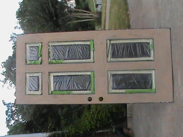

bubbles on front door after painting
Old 07-23-20, 08:39 AM
S
Join Date: Jul 2013
Location: usa
Posts: 157
Received 2 Upvotes on 2 Posts
I stripped the paint from the door withe chemicals and sanding and cleaning (wiping it out),I put the oil base BIN primer,and all surface enamel satin (black).I sprayed it withe homeright sprayer .I put 3 coats of paint on it.Living in georgia and being so hot,it makes it hard.I painted out side and it bubbled,I painted inside and set the door up (letting dry for 3 days) the bulles show s up again.I have done this 2 or 3 times and bubbles come back and only on the front side.

You should be able to pull the paint away and figure out if the primer held or if it's the latex coming off the primer. Let us know what you find.

It 's coming off the primer.

Does your Bin primer say that it's interior/exterior or interior/exterior spot?

These are the prime and paint that I used.

You got two things to consider, any time you mix latex and oil based materials you have the opportunity for checking (interaction), and heat, hot conditions, hot substrates, which one, I dont know!!

The oil base is the primer and I put that on both sides (the rest I did not understand) This is happening the certain spots and only upfront,,

There shouldn't be any issues applying latex paint over dry BIN, it gets done successfully all the time. Bubbling like that usually indicates a contaminant that isn't allowing the paint to adhere. How soon after the paint is applied do the bubbles appear?

When it says "spot exterior" that means it should not be used on large exterior areas. So you should have picked a different primer.
I probably would have used Rustoleum Rusty metal primer... The red color is a good base for dark colors. After priming you should always scuff sand the primer to help with adhesion... Then dust it off. Especially important when spraying.
And in high humidity and heat you need more cure time between coats. You don't recoat when it's just dry to the touch. Whatever the can says the recoat time is you can probably double or triple it in high humidity.

If the bubble occur after the door is dry and then exposed to the sun it may mean that the paint was applied too thick and didn't dry properly.

With white primer and black paint I bet the first coat was way too heavy. Your brain thinks the first coat needs to completely cover the white.

Forgive but you said bare metal and my front door is not metal.Does it matter?
Old 07-23-20, 03:54 PM
XSleeper's Avatar
Join Date: Dec 2004
Posts: 27,203
Received 1,948 Upvotes on 1,748 Posts
If it's not a metal door I would not use that, no. Instead I would use a similar product... Rustoleum Bonding Primer (grey). It bonds to almost any surface and can be top coated quickly. It does say that it has a 200F limit, so I dont know how hot that black door gets in the sun, but that could be an issue if it is getting that hot.
A similar product is Zinnser Extreme adhesion primer, or Sherwin William's Bonding Primer.
I also worry that your bubbles are going to keep spreading or that more will appear unless you strip that exterior finish and start over. Even if no more bubbles appear, I imagine that you will be able to see the existing bubbled areas through your topcoat. They will look like rings through your topcoat.
Norm201, scrambledlife voted this post useful.

I'm thinking you sprayed too many or too thick of a coat of the black paint and while it was dry to the touch, the underlying paint was still tacky. Not sure why that would have made the blisters but other than a contaminate that's all I can think of.
If you strip it down to bare wood it's best to use a primer. No problems with painting it in the garage.

Probably should have been mentioned earlier, painting a lighter color may help, cant even imagine how hot a black door must get especially if it gets any sun on it!

Looks like incompatible primer/topcoat interaction to me. I would use a primer and topcoat of the same type and by the same manufacturer which should almost always ensure they are compatible.
I’ve seen the same type of thing happen with epoxy paint over lacquer primer. Different paints entirely but they bubbled up just the same because they were incompatible with each other.

Since I did find Rustoleum Bonding Primer (white),I stripped the all front section and washed all the dirt off.I sanded real good(marksr) and used my airgun and large paint brush and sanded again,cleaned it again.Let is dry good and put the prime on it sunday.Monday I gave a lite sand and dust it off good and put the first layer of paint yesterday(monday 6pm).It's been 20 hrs and so far good no bubbles smooth.I will put the second one wednesday and let it dry good.Still learning.

I put the 2nd coat on yesterday (wednesday) and thursday afternoon looking good so far.It is raining too much I wait couple more days and see.I post picture when is done.
