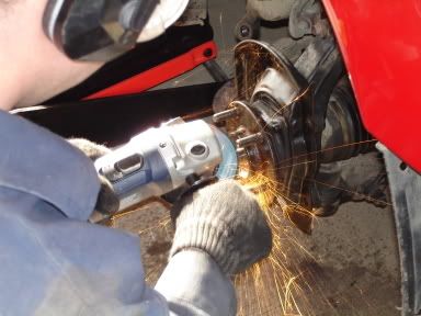

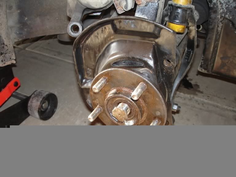

Actually, I own a 95 GST project. Worst axle job that I've ever done. 30 minutes of sledge hammering, than grinding with an angle grinder to get the splines out of the hub. Then broken bolts to follow. Car was down for 3 weeks. The job above was easy compared to mine, heheh. It's a common problem for the splines to be rust welded in DSM's, not enough lube used during assembly is what I heard.

Grinders, cutting torch, BBBIIIGGG Hammer. Go DIY!

Didn't have a puller you could use or was it too much even for that?
After reading multiple other threads/experiences, people had better success with a sledge than using a 10-tonne press.
And ya, GO DIY!
