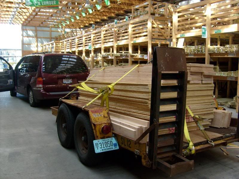

I got stupid. I was building a garage/apt and hauled a few HUGE lumber loads about 40 miles with my V6 Ford Windstar (3.8 2000 yr w/97K Miles). I was obsessed with the building project and it turned out the van was very low on oil... up to 3 quarts anyway.
Now I changed the oil numerous times and the filter....but boy does it ever burn oil between changes now. maybe 2 quarts / 1,000 miles?
What did I likely damage?
Is the life of the engine likely greatly shortened?

Where's this oil going? Is it leaking or burning? It can be only one of those.
Check your coolant and see what color it is.
Could be a number of things like bad valve guides, headgasket, etc.
Does it smoke?
If your motor leaks or burns 3 qts of oil it is in dire need of rebuilding or atleast new gaskets. IMO it times to either spend some serious $ on engine rebuild or trade for a newer vehicle.

I would be guessing rings badly worn now maybe.
How big a load of lumber are we talking about; rear-bumper-dragging big?
Agree with Lou; I'm surprised the tranny didn't go after just ONE trip like that.

ANswer: It was hauling a tandem trailer that normally hauls a skid steer and more. Trailer was very heavy duty and I had her loaded down 6 feet tall in 20 " lumber lengths etc. Very heavy

Yeah thats a big load for that van, you probably would have messed up the engine no matter what
, tranny or brakes too, how did you manage to slow down ? I don't suppose you have an electric brake controller installed on minivan...

Yep, that is the van. NO, I had no brake hook up to the trailer.
I WAS tough to do anything.... pull from a stop, brake to a stop, and keeping if from swaying. DAMN I was too focused on building the garage / loft!

I hauled a utility tractor on a dual axle trailer with a Ford V6 (small engine) 1/2 ton pickup. The tractor weighed 3800 lbs, trailer 1500, total 5300. The trip was 40 miles on low grade Florida hills. No electric brake, just like your setup in the photo. I see your trip comparable to mine, same distance, same trailer setup, same load, almost same vehicle. I was watching temperature gauge but it stayed low. You may want to replace transmission oil if it does not have a decent size aux transmission oil cooler.
When a car hauls an oversized load, the first concern is transmission. Apparently, your transmission handled the load. If the engine was damaged (I mean IF it was), it was because oil was low and not because of the haul. Please don't blame self for the lumber hauling. It was a doable job for the van, maybe near the upper limit but not outrageously underpowered.
