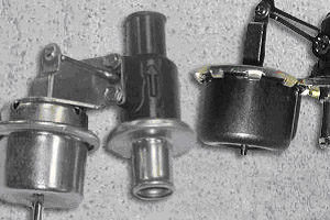

Most definitely check the heater control valve under the hood that is in-line with the heater hose going to the heater core. A lot of them are vacuum controlled and a loss of vacuum at that valve will cause it not to open. Also use a hand held vacuum to test it as well. I have seen the diaphragm dry rot and leak causing it not to open.
Also on some of the heater valves you can actually see if it is opening and closing. You will see a rod or linkage on one end. Just switch it from hot to cold and note and differences. Here is an example...

This vehicle does not have a valve.

found this
ACDELCO Part # 155372 {#22532158}
Category: Heater Control Valve.
It does not look like a valve but a thermostat of some sort that lets hot water in.
Also check that vacuum can under the hood it should look like a big plastic ball with a couple of hoses going to it it would run your blend doors.

The coolant nipple has a valve in it? I'll be damned. All the ones I've seen are just a wide open fitting.

He hasn't responsed yet to my question about the hoses, so that would determine this "valve" is operational.
On a side note, I've never seen one of those valves before..
