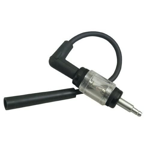

(Question) Can you remotely test for spark, when driving the car?
Confirming spark delivery on a moving vehicle is easy. On the other hand, confirming spark delivery to all the plugs, on a moving vehicle, well that’s a little different. Why does my gut tell me we’re talking about your 6 cylinder Chrysler here?
Two cylinders or twenty-four cylinders, it doesn’t matter. I’ve read your questions and responses, and I can tell you’re a smart man. Below is a picture of a standard “In Line Spark Tester”. Sooooooo, I’d like to hear how you would confirm spark delivery to all the plugs on a moving vehicle?

Master - At driving speeds wouldn't the flicker of the light be too rapid to detect anything other than complete spark failure?
Old 09-03-10, 01:25 PM
ASE MASTER's Avatar
Join Date: Aug 2010
Posts: 560
(Question) At driving speeds wouldn't the flicker of the light be too rapid to detect anything other than complete spark failure?
Good point tow guy.
True in most cases, but not all. Depends on vehicle, type of ignition system and amount of ignition voltage generated.
Furthermore I took it to the next level.
Thinking ahead. So posted an image of a tester that uses a “Neon filled Gas Tube” as opposed to an “LED” (Lisle 20610).
Flashes and still visible at high rpm.
Tip for you and ecman51. Test at night.

Ok ladies,
Any takers on why the timing light idea won’t work?

Gentlemen,
By hooking up a timing light, and revving the engine at idle you’re not going to get the answer to the original question. Just as a reminder the question was:
How can spark delivery be confirmed to all the plugs on a moving vehicle? (In this case a 6 cylinder vehicle).
Let’s define moving as 40 to 60 mph. The operative word here is moving. An “In Line Spark Tester” attached to each of the six plugs, shows that spark is reaching all the plugs at idle. Well, that’s at idle. Could a:
Distributor issue
Rotor issue
Cap issue
Ignition cable issue
Wiring issue
Coil issue
Module issue
Sensor issue
ECM issue
Voltage issue
Cause the same car (that has spark at all 6 plugs at idle), loose additional spark when driven at roadway speeds?
The answer is yes?
So how do we check for this?
Six timing lights cannot be used, because at roadway speeds the bulb in the timing light will flash so fast that it will give the illusion of being on steady, and would be so faint that it won’t be visible. Furthermore a timing light is not an in line spark tester. The image of the “In Line Spark” tester I posted ( Lisle 20610 Inline Spark Tester) uses a “Gas Filled Neon Tube” in place of a standard timing light bulb or LED. Neon gas is much brighter than a standard timing light bulb or LED. The fact that its neon means that it’s not affected as greatly by ignition pulse/voltage, so it’s easier to see.
Soooooooooooooo
Attach 6 of the of the above mentioned testers.
Remove the hood so you can see the testers, or extend the wires on the testers so they reach onto the passenger seat.
Run your test at night.
Beer 4U2
