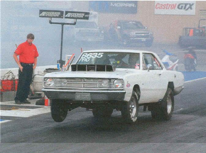

(Quote) I'm extremely mechanical and have built 9 second 1/4 mile pro stocks when I was a younger man from the ground up.
A man after my own heart.Beer 4U2 Have you beat by a second buddy. (Images below).
