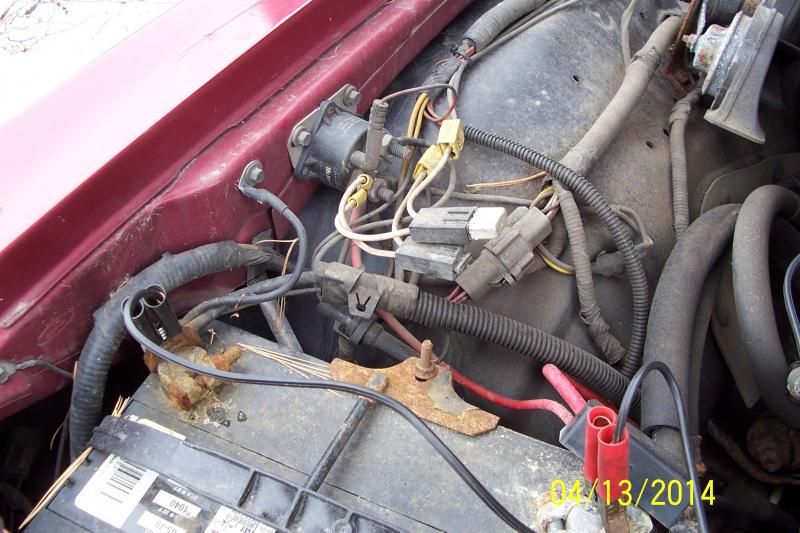

Poor car sat buried in snow so I didn't get to start it for almost 3 months, I usually start it monthly. Well, battery was about dead so I've been charging it. According to the charger is should be about charged now.
When I hit the key I just get a click from the starter relay on the fender. Been a hundred years but can't I jump the relay somehow? The small red top wire to the red from the battery or is it to the black wire going to the starter?
Not sure what those white wires and fuse is for, maybe for the trailer brakes?

Are you sure the battery is charged? That the battery is still good?
Don't jump the relay, get another vehicle and jump start the car. See if the starter works then.

Not sure what to think now. Few days ago I went to clean the terminals, thought I'd give it a try first. Click...click...vroom....started right up. I did notice with the two clicks from the relay the interior lights didn't dim like I would expect if the starter was trying to turn or a loose connection.
Posts and cables were clean and shiny and very tight. I did change the rusty bolt while I was there.
I have started it a half dozen times since, no problems.
So, guess I should drive it more than once or twice a year?

If it "clicked" and the lights didn't dim (and the starter didn't turn) then you still have an intermittent problem.
Starter or solenoid.
You will need a meter on the 12V line from the solenoid to the starter so the next time it "clicks" and doesn't turn over you will know if the solenoid worked (12V to starter means it worked).
It would likely be easier, more time/cost efficient to change the solenoid so the next time it fails you will be quite assured that it is an intermittent starter.

Curious about something. Does that relay/solenoid on the fender always click and I just don't hear it when the starter is turning?

You only hear the solenoid click if it's unable to immediately forward the current to the starter.
This statement is correct .. it always clicks . (if it is working correctly)
A solenoid (relay) has 2 circuits in it.
1) The "primary" circuit which is energized by the ignition switch. This pulls the relay contacts together (click)
2) The relay contacts make the circuit allowing high current power to energize the starter (sometimes they don't make an electrical connection if worn or defective).

I probably should have clarified, it does click but it's momentarily and I don't think you'd hear it if everything is working properly. The solenoid on my tractor is 6" from the starter button and I never hear it click unless there is an issue.
Before I'd replace the solenoid I'd make sure all the connections are clean, cables good and the battery fully charged.

Those white wires are an add-on, and not original to that car. Turn your headlights on and stare at them as someone tries to start the car. If they dim considerably, batt is shot. If they don't dim when the key is turned, it's not the battery.
Get a voltage meter, check battery voltage. Have someone turn the key and check voltage on the starter side of the relay, to see if it's getting 12v to the start side of the relay. If it is, verify 12v at the starter cable on the starter. IF there is, pull starter, have tested at parts store, it's probably shot. No 12v on start side of solonoid while turning the key, solonoid is likely shot. Those ford solonoids rarely go out though, so it's "likely" not your problem
