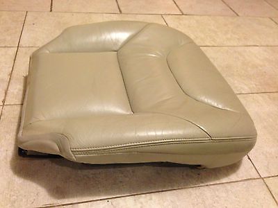

Here's a picture of my driver's seat cushion with the leather skin intact:

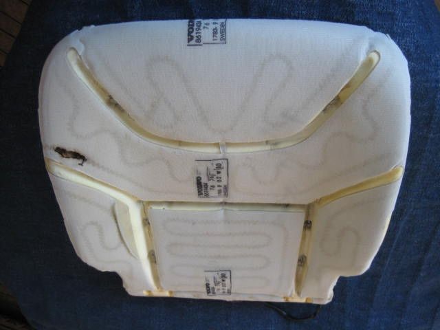

Looking at the leather, you wouldn't know that the heating coil had burned out. Let me remind you that neither of the two 15 Amp Fuses had failed. Here's a photo of the foam cushion after removing the leather . . . . you can see the heating coil barely visible through the pad that's glued to the cushion:

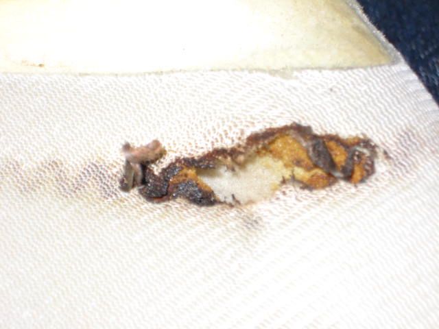

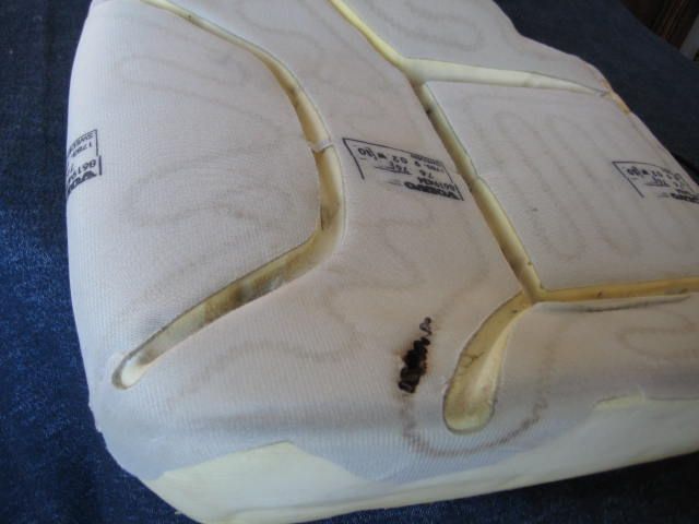

You'll note the little brown burned area in the lower right . . . . which resides right below the Driver's left thigh, a few inches above the knee. This is not an area where we recall there ever having been any mis-treatment of the seat; neither when it was being actively heated nor during the majority of the year when the heating unit is just resting . . . . but still vulnerable. My burned filament is in a position where it almost looks like someone stepped on the seat in that spot.
Here's a closer look at that burned area:
Some folks say that you might be able to repair such a break/burn by soldering the filament . . . . but that's not in the cards for me. Maybe I should practice with the heating pad I just removed ?
I was prepared to buy a new heating pad; but my Mechanic drew my attention to a used cushion off a donor vehicle with a mere 120,000 miles on it (my Volvo has 253,000 miles, so 120,000 is hardly broken in.
I also took the opportunity to reinforce some stitching in that leather which needed attention, and the skin was re-installed over the replacement cushion and all is well now. I've retained my original foam rubber cushion. Just in case I need to replace the newer (but still used) heating coil, I'll buy one and glue it onto my old cushion in preparation for the physical activity involved in removing the seat and swapping out the cushions. I'm not too worried about it; but my Mechanic is now pretty skilled in removing and re-installing these seats !
In my case with the Volvo S-60, the cushions and heating pads are interchangeable between the Driver's side and the Passenger's side . . . . but it's always the Driver's side that get's the most wear/usage, whether it's being heated or not.

To my untrained touch, the filament feels very pliable . . . . not even metallic, like the wick of a candle. Actually, it's like the heating element of an electric blanket, and somewhat flexible. I can't imagine soldering it and still retaining that required flexibility.
