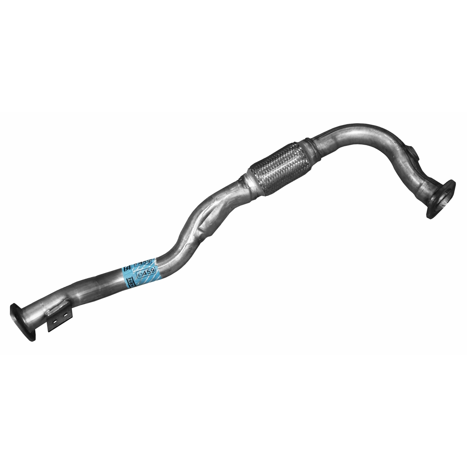

This year, it did not pass thro’ motor vehicle and I was told, it has exhaust leak/hole/crack somewhere...,… as it sounds like some hole in front exhaust pipe, either below the engine in manifold connection and/or in steel flexible pipe,…and also,...... they checked it with their sensor,…. inserting at exhaust pipe and also below the steering wheel’s dash board….. and It FAILED at Motor Vehicle.... They say,.. air and also fumes is coming in the exhaust, so there is hole in the front exhaust walker pipe / steel flex pipe,..,….and air is getting in,.. ( OBD test was passed )
It failed in safety for exhaust,..
Probably below the engine, in manifold pipe / front exhaust pipe ( part no. 53459 ) has a hole/crack ( not noticeable any smoke is coming out ) and/or also hole in flexible steel pipe,….
And while getting free estimates for 3-5 guys, ( they lifted / jacked the car and inspected at PeopBoyz / ASAP / Meineke / 2-3 private small guys,.. n' their opinions vary,..
Most says,…. Cut and weld a new steel flexible pipe,… ( risky to do teh work on all rused 21+ yrs old pipe though,.... ) but we dunn'o if there is more problem in manifold / catalytic converter or elsewhere in pipe too,.. we know only, once opened,..
Few others said,....... rather replace the front exhaust pipe as one piece all the way to catalytic converter,…. ( so, you do not need to cut/weld/build on the old rotten and corroded pipe,.. But still teh flanges at both ends of the other connecting pipes are gone/rusted / very thin,..
Few said, Catalytic converter also need to be changed,…
Few perfectionists said, whole exhausted system is old, rotten, rusted, all flanges are gone,… so better change and replace the whole exhaust system,… around 1700+ dollar estimate ( my car was bought for 1700 dollars 9 yrs ago )
I dunno wanna spend more money , and if done by tapes/pody/cement/silver tape for flue gases / bandaid rolls,….just for passing the inspection be suffice,…… ( Car is on its last leg for another 1-2 yrs as I drive extremely little )
No one is ready to use, cement, pody, masking tapes, bandage rolls and such to temporarily fix it just to pass the inspection,. As my car will have to scrap after 1-2 yrs, as it’s old now, and has also problem with hood ( opening string broken ) and low mpg s ( average giving ) ,. Also has 155+K miles,…
My question is,… where do you generally order the required parts economically ?
( front exhaust walker pipe ( California mission ) part no. 53459 and its related gasket nos 31332 , 31534… )
Pepboys and autozone are expensive, as they also buy from third party vendor many a times with middle man profit,….. e-bay and amazon are risk as, to and fro whipping will kill you.,…… Any solution ?
Also, Chilton or any good service repair manual you would suggest for this car? Any advice/suggestions,… ? How would I get a complete picture from any good repair service book / PDF copy available on-line,.. etc ?
Most probably I will have to buy this whole long part with two gaskets at each end, and still not sure, may/ may not need catalytic converter too. Few said yr muffler is new, so all are talking about basically, the front exhaust walker pipe,…. ( No. 53459 )

OK, so do you have hole or not? I saw dozens of opinions mentioned, but have you actually SEEN a hole or crack in pipe itself?
Exhaust leak outside where you mention it is normally worn out exhaust manifold to flex pipe seal. A large steel wool and some high temp plastic donut. That's like 20 bucks part and about 30 min job on 4 banger. Much more casswork and labor on V6, I did it.
So you need to first determine, if there indeed is a hole or not.
You know how to actually see it? Wait till it's pitch dark. Start engine. Pop hood open and look down at exhaust. If you see any FLAMES coming out, you do have hole or crack. You won't see "smoke".

flex pipe would be a common area for a leak to develop on most cars they do start leaking at the flex pipe eventually, but if your not certain where its leaking from and you only value the car at 4-5 hundred dollars i think the obvious solution would just trade it in on a new or used car that is in better condition.
