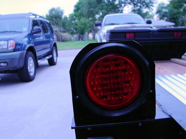

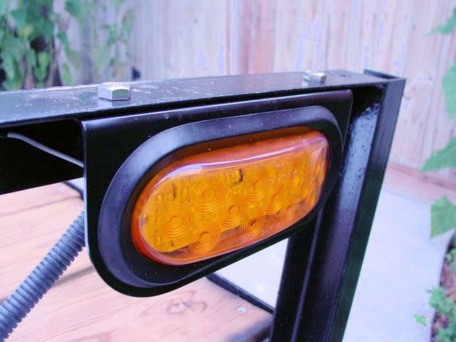

I have hooked up LED lights on my utility trailer. I used 2 red round lights and 2 oval amber lights.
Both sets have three prong connections. The connections are labeled Tail, Ground and Stop/Turn. They are quality lights and are brand new.
I have the trailer wired with a standard 4-way wire connector. I wired with the following color code. White - Ground, Brown - Taillights, Yellow - Left Turn & Stop, Green - Right Turn & Stop.
I grounded the trailer at the hitch and continued with the white wire and grounded it again at the back of the trailer. Each light is grounded to the trailer also.
I also soldered all my connections as I just rebuilt this trailer from the ground up and wanted a clean install.
Well, I hooked the trailer up to the hitch on my '98 Durango and plugged it in. The turn signals on all the lights, red and amber work. The brake lights on all the lights work also. So everything is working so far like it is supposed to work.
Though as soon as I turn on my headlights, ALL the LED lights come on like they are supposed to but it cancels out the brakes lights and turn signal functions.
I can have the left turn signal blinking on both red and amber lights, then turn on the headlights and all four lights come on and it stops blinking. Without my headlights on, all the functions of the lights work like I said.
It is just when I turn on my headlights that they all light up properly but cancel out the brake lights and turn signal functions.
The trucks lights, turn signals and brake lights are not affected by this at all and continue to function properly.
I have also hooked to the trailer up to my wifes Nissan Xterra and it does the same thing. I did this because I know that Durango electrical systems can be screwy.
Both sets are labeled this way

Ok, I figured out the LED lights. These lights can only be used in one mode so to speak.
They can be used either as taillights or brake/turn lights. That is why on the back of big rigs, dump trucks and such, you see 4 red round lights and sometimes two amber round lights.
Two are set up for brake/turn and the other two are set up for taillights. When you see the amber ones with them, they are setup for turn signals while two of the red ones are for brakes only.
So what I did was get two red ones that are setup for what I need. I will simply replace the two red ones I have on there now. these are also 62 LEDs per light, so I will not lose any brightness.
They are wired so that they will act as all three functions. When I pull my headlight switch they will come on, then get brighter as I either apply the brakes or use the turn signal.
I could have just added two more red ones to my trailer, but thought that would be overkill. So going with these new ones will simplify everything.

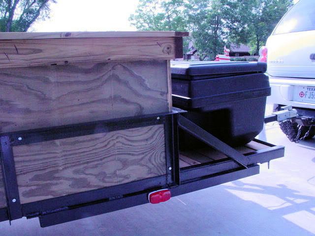

Here is the setup I have. I'm about to secure all the wiring nice and neat. Also build the new tail gate, then take it down for new tires and rims.
I'm adding two more of these small red LED marker lights to the back down below the amber ones.
Since I just rebuilt it from the ground up, it should last me another ten years!
