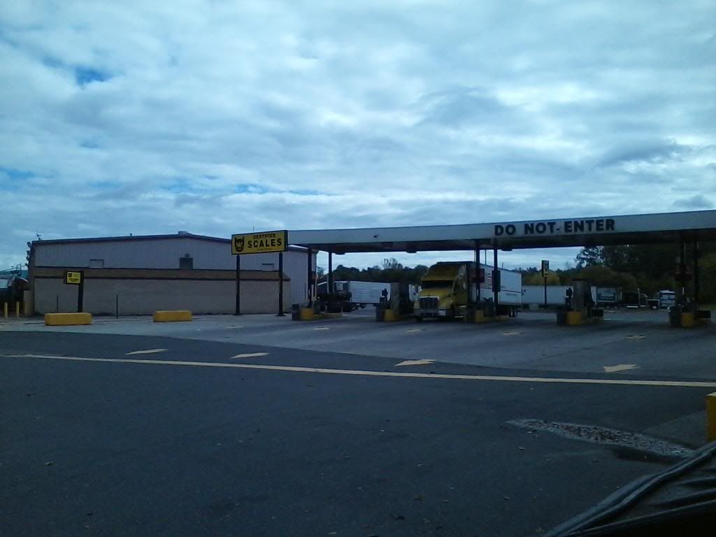

Anyway for my own amusement I went to cat scale yesterday to check my weights.
What you all think?
Weighing #1 -- TT attached and Weight Distribution Activated

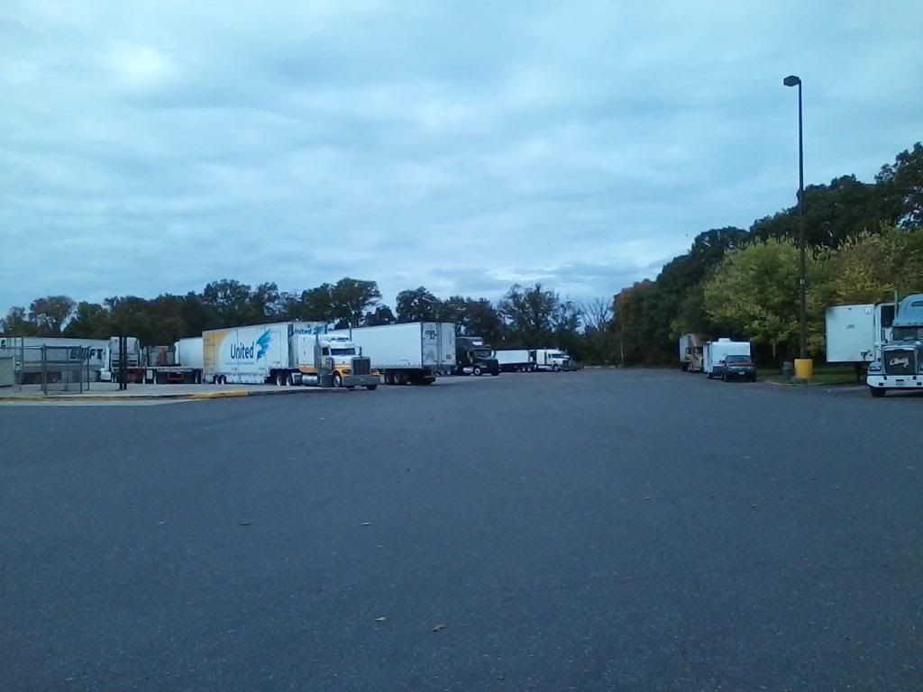

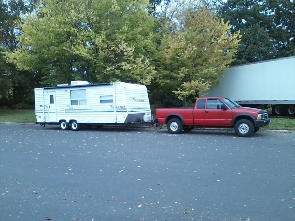

Here are the scales....Ol red and new camper.
( Got to get to map guys to paint his house... " Inside joke". Trooper will know..
I can tell you there were some women walking around in the parking lot scantly clothed. Its close to Halloween so they kept asking me for a trick or something..??? Dont know if thats normal.???? This was a truck stop right off the NJ turnpike.
