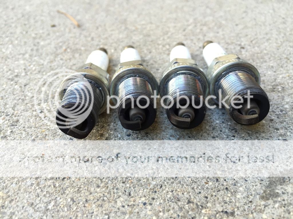

I also just looked at my spark plugs, they are not wet, but they do have more carbon deposits compared to how they once looked.
Here is a photo of how spark plugs look just now(cylinders 1,2,3,4 left to right) :
And here is how they looked in 2009:
Could this finding be related?
I will look for vacuum leaks next. But that seems like a difficult task. Most of the vacuum network is behind something else, and it’s a maze too. That is why I was trying to start from the easier probabilities.

Those plugs are not in good shape. At least clean them with some emery cloth or sand paper if you can't get hold of a new set.

Pulpo, thanks for confirming. I imagine the plugs in the second photo look ok (except cylinder #1 is a little darker in the older photo too – but overall ok back in 2009 right?)
The plugs are not old though. I think whatever deposits they have it’s just a symptom not the cause. The fact that they are also all equally black, probably rules out any single injector having gone bad.
I have a hunch this is something to do with the IACV (Idle Air Control Valve), AAC (Auxiliary Air Control Valve) , FICD (Fast Idle Control Device) complex of devices – though I have not figured out exactly what each one device does. I have the shop manual, I’m doing a bit of reading. I have to return home tomorrow 200 miles away, so I’m in a bit of a bind with everything closed for July 4th.

You are right about it being the symptom & not the cause & also right about the IACV. There might be a way to clean the IACV. I don't remember. Clean the plugs enough to get home, if that's possible. If you can replace the IACV, that might be better.

Here is how spark plugs look today after 18 mile drive( 10mi freeway + 8mi city). About 10 short episodes of sputtering at highway speeds and two stalls at stoplights.
Do these still indicate “rich” combustion?

They indicate running a little on the hot side but not rich. The plugs are not the problem, IMO

In any case, when I took out the spark plugs to do the compression test, here is how they looked (engine had been rough idling for about 10 minutes before I took them out).
I cannot see any unevenness, implying something might be wrong with one or more cylinders.
So what is going on?
