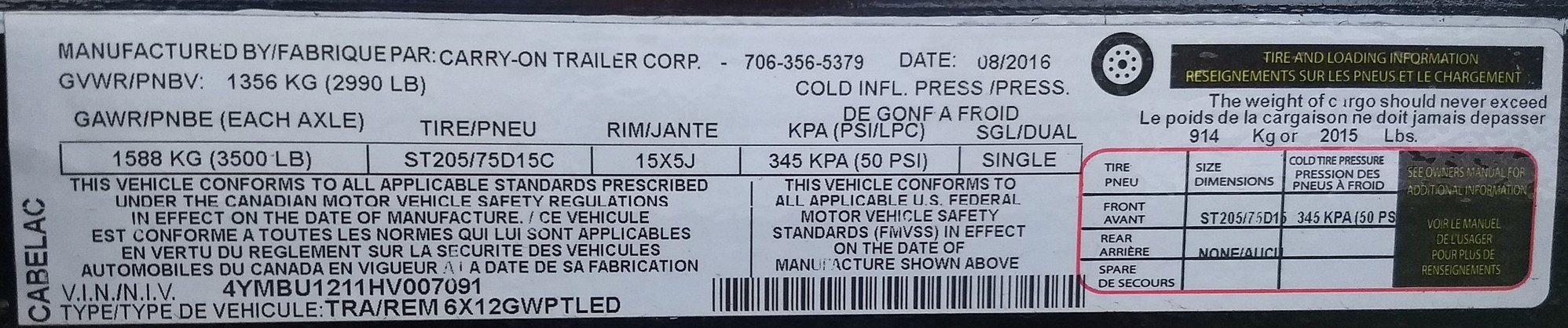

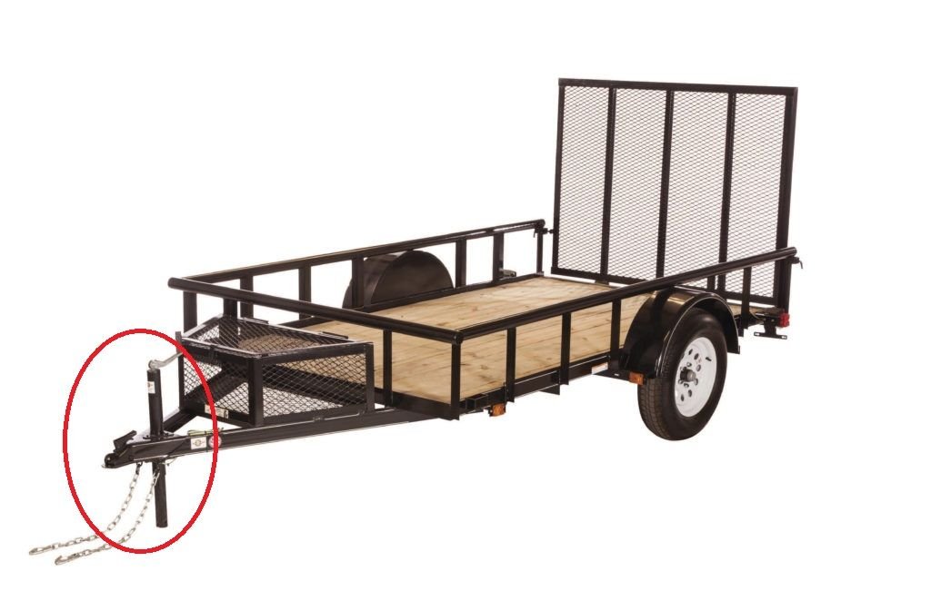

I have a fixed trailer jack on my trailer.
While pulling it up the road at my cabin I hit piece of high ground and the bottom of the jack hit the ground. It bent the lead screw so now it's very difficult to raise and lower (although it does work).
I want to install the flip up type or swing back.
My question is can I install that type and how should I size it in terms of capacity? Should I rate it at the 2000 lbs. top wind jack as originally installed, payload capacity of 2015 lbs., empty weight of 975 lbs. or should I use the 3500 lbs. rated idler axel?

The jack is only carrying the weight of the tongue and you will likely not park it with a heavy load on it. I think you would be fine with a 1000lb jack. Plus the wheel on the jack will be easier to move the trailer without the truck.

Looks like I solved the problem. Took a trip to Lowes and they have a Carry-On brand 2000# capacity (as specified by Carry-On) bolt on swing out unit. For $36.00. Bought it! Will install next time I'm at the cabin where trailer is currently stored.

No it's not true that anything above 1500 LB. has to be welded on.
My 30' construction trailer, and my 16' 7000 capacity trailer both have bolt on Vee type jacks like you had.
If you bought what's called a snap ring type jack there made to fit a wide range of widths of tongues.
I always add a spacer on the top side to fill in the gap between the bolts and the frame to keep it from wanting to twist.

The original that is on there now has three bolts holding on, but also seems like the top plate is welded to the frame. I don't have it in front of me so I can't say for sure. If is I assume the crank and screw will drop out of lift up out of he tube.

Installed out in the field. Fit very nice.
