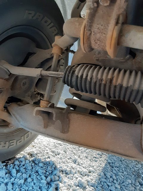

My 98 Ranger is leaking power steering fluid apparently rather significantly from within the steering rack(s) or whatever these are properly called. I'm guessing a rather involved and/or expensive fix to take care of. Without much further investigation I suppose a seal or seals are shot within. Any suggestions/comments/advice appreciated.

A new rack and pinion cost about $200 for the part Takes 2 to 4 hours to replace. There are some snake oil type stuff that claims to restore seals. Blue Devil has the snake oil. Better to replace I think.

I think you need to open it up to see if it's a good candidate for rebuilding. If the boot has been torn for a while the rack may have rusted which eats up the seals in which case you'd need a replacement. But if you caught it early you could rebuild it with new seals.

Ill take a good look see if the boot(s) are torn at all. Don't think so but will check closely. Thanks

So apparently two rack and pinions needed $400, plus maybe 8 hors shop time.
No there is only one rack on your vehicle and it shouldn't take more than 3 or 4 hours total in a shop, and that would be a tad much.

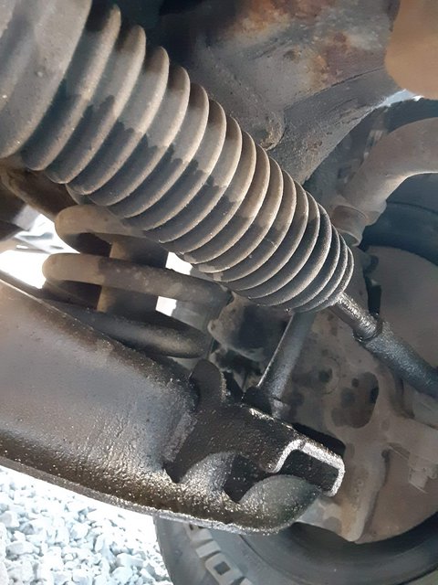

Yep I checked, and sure enough both have torn spots where the shaft comes out and is exposed from the boot(s).
