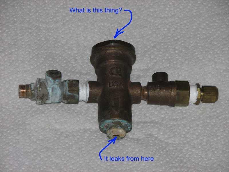

What is this thing? Can I repair it - it leaks?
Old 12-21-08, 08:59 PM
Join Date: Dec 2007
Posts: 14

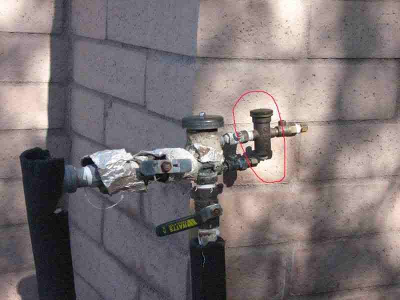

The water supply to the drip irrigation system here has a back flow preventer and what I think is some kind of testing setup attached. The thing circled in the picture leaks from the bottom at a steady drip-drip-drip. Water is expensive and precious here in Tucson so I was hoping someone can tell me exactly what it is and if it can be rebuilt.
Thanks for any help!
[IMG][/IMG]
[IMG][/IMG]

looks like a vacuum breaker to me. I would take it to my local hardware/home improvement store and get a new one. They are not that pricey like 20-25 bucks

Well, you have stumped the plumbingods on this one . I have installed many back flow preventors and have never seen that item. I would just put the test **** back on and leave that other part out but available, in case it is needed by the irrigation guys or the water dept.
I am not familiar with the insignia on that item either. Could you possibly take more pics of it front and back and see if we can find more numbers or something. If we can figure out who makes it, I should be able to get some answers for you.

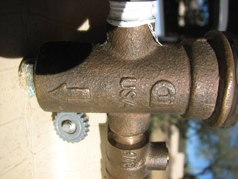

More pics
I played around with the macro setting on the camera I got for Christmas last year. It takes very good closeups!
Here is the body of the thing I'm trying to identify. It has the same markings on both sides.
[IMG][/IMG]

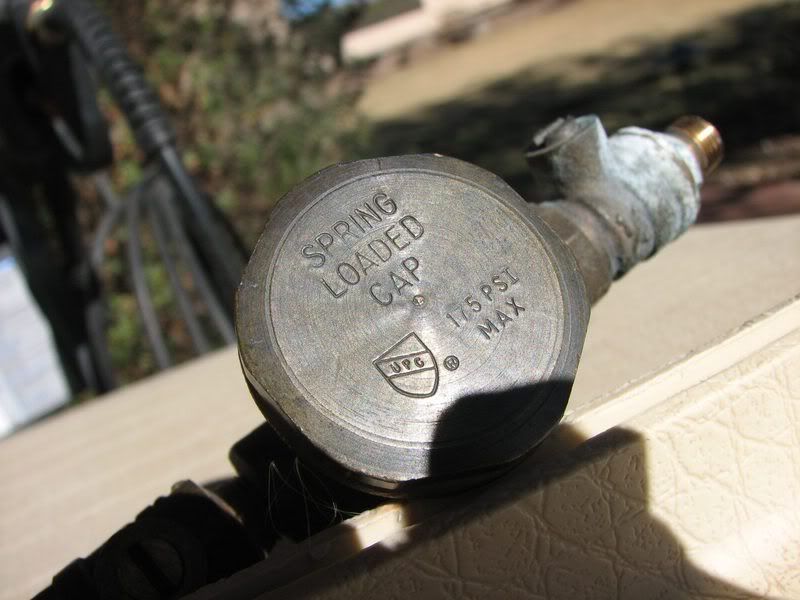

And here is a closeup of the top. The top looks like it screws off.
[IMG][/IMG]

edit: it is 3"H X 1"D.

I found it !!!!!!!!!
I found it
The CII on the valve made me think of Conbracco Industries Inc., which I guess is the same as Apollo
http://www.apollovalves.com/_product...pv/IOM_FPV.pdf
http://www.apollovalves.com/_product.../TS_30-000.pdf
http://www.apollovalves.com/_product...0-000_1048.pdf
This should give you all the info needed. It is a freeze protection device. I saw one similar on the Watts web site, but now that I found the exact match I feel better.

Uh oh
Looks like I better put it back in place until the weather warms up. It's been down into the mid-20s at night here lately. Thanks very much for your help!

How do I take the cap off ?
I have the exact same problem with the unit leaking even when it is warm. I was told that I could clean the inside of the valve but having a hard time taking the brass cap off.
Any suggestions on removing the brass cap ?

Old 03-12-10, 04:47 AM
the_tow_guy's Avatar
Join Date: Feb 2001
Location: SW Fla USA
Posts: 11,808
Received 29 Votes on 23 Posts
Pipe wrench I would imagine; you can just see the flats on the sides for wrenching. Not sure how much spring pressure it will have on it, so I'm not sure how dangerous disassembly will be.
May also need a second wrench for holding the body to prevent possible pipe damage.
