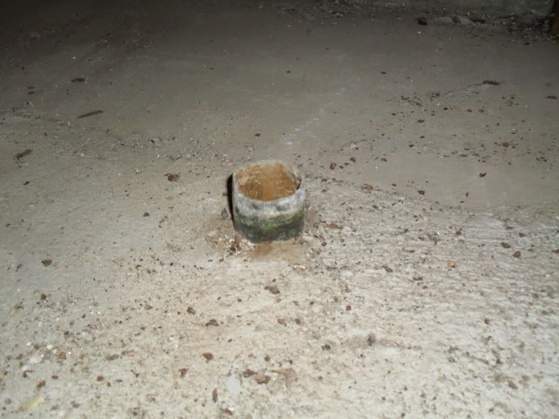

I just ripped out an old metal shower in my basement. it had a 2" slab poured for the base. I broke that apart and removed it. This is what I am left with
its a 1-1/2" lead drain it looks like. is there any way i can use this, or am I going to have to jackhammer out the slab and replace pipe?

Plumbing codes require 2-inch drains for showers. If this job is by permit and will be inspected you need the 2-inch drain. You also need a trap and a vent so ripping it all out and starting from scratch may be the best in any case.
