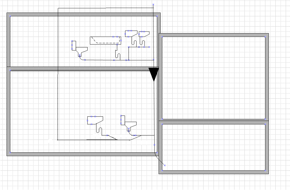

Downstairs Toilet gurgles when upstairs toilet is flushed
Hi All,
New to the boards but hope to return often.
My problem is that every time we flush our upstairs toilet, our downstairs toilet gurgles. Here is some background details.
Our house was built in the 60s; moderate sized split level home, and only has two bathrooms. I remodelled our upstairs bathroom when we first moved in in 2006, replacing the original toilet with a stronger flushing toto model. When we first moved in we also had drain problems, but resolved by snaking out the main drain line to the street, cutting roots, etc...
However, we've had this problem with the downstairs toilet as long as I can remember, but not sure if it existed before I replaced the upstairs toilet.
I've read that the problem could be blocked vent stack or blocked drains but both of those seem to be just fine, and I've used chemical products in the past to help ensure the drain was clean. I've confirmed that the vent stack is not blocked by spraying water down and seeing/hearing it drain without problems.
I've also had a plumber out but asked them to leave when they started complaining about possibly having to pop the toilet up.
I'm now at the point where I'm remodelling our downstairs bathroom, down to the studs, and thinking now is a good time to get this fixed once and for all while there's access to pipes. (I'm fearing that additinoal vent lines may need to be installed)
I also wonder if now that I replace the downstairs toilet, if this problem may not even exist again, and thinking about installing the new toilet temporarily to see. I currently have the downstairs toilet and sink drains blocked off completely and there is no problem with flushing the upstairs toilet.
Looking to see if anyone here has thoughts or ideas of the possible problem and what to do. Thanks in advance!

When they gurggle like that it means:
1) There is some blockage in the line an water backs up to the vent for the toilet down stairs. Its gulping for air, then blocks the vent a little then gulps, then blocks...ect
2) Are you on a septic? Sometimes the septics get full and cause the line to be partially filled.
3) Sometimse they did not pipe to code and the downstair may be wet vented with the upstairs.
If you are gutting the down stairs I highly recommend you draw a diagram of how the up and down baths are all tied together. You have a great opportunity to repipe the down to its own outlet and seperate vent if indeed you are wet vented.

I think I have a wet vent, as you described. I assume that means the venting for downstairs is done through lines that also drain waste water from upstairs? Here is a crude diagram. I only have access to the bottom floor portion of the vent stack however while the downstairs is gutted. (well actually most of the upstairs bathroom drain lines to the vent stack also, as they are in the rafters above.)
I was thinking that I may need to install one of those one-way air vent valves maybe?

Here's a few pics that show my access options downstairs. As you can see, the main drain/vent stack swings over to the other side of the block wall, into our crawl space, where it has a clean out and then goes horizontal out to the street. I have access to that area as well. Pictures by goodfella9000 - Photobucket

I would have the main drain line to your house cleared (again) and see if that corrects the problem.
Where I live (Manitoba), if you add a toilet in your basement, there is no requirement to have any sort of vent on it. You merely need to cut into your basement floor and connect the new toilet to the main drain line from the house.
Now, also remember that the drain from the kitchen sink will typically also empty into that main drain line, and it's the solids that go down the kitchen sink drain that will typically cause that main drain line to gradually clog up.
What happens if your main drain line is partially clogged and the upstairs toilet suddenly dumps 5 gallons of water into that drain line so that the water comes into the drain line faster than it can flow through the partially clogged section?
Well, the water backs up the drain pipe to the downstairs toilet, and the air gets compressed in that basement toilet's drain pipe until it comes gurgling out the toilet bowl.
I don't believe that putting a Studer vent on the sink will help at all, unless you install it backwards. A Studer vent is nothing more than a spring loaded check valve. When the pressure in the drain piping goes BELOW atmospheric pressure and threatens to suck the water out of the p-traps, the Studer vent opens to allow air into the drain piping to relieve that partial vaccuum. In this case the problem is not a partial vaccuum in the drain piping, but air pressure in the drain piping. That's something that's going to assist the sprink pressure in keeping the Studer vent closed.
Try this:
Pour three or four 5 gallon pails of water down the downstairs toilet (in quick succession, pausing only shortly between pails to observe the flushing action). See if each pail is followed by a strong flushing of the bowl. If the first one or two are, but then the toilet seems to loose it's gusto and the water only drains down the bowl slowly, that's confirmation that the main drain line is partially clogged. You have at least a 3 inch drain pipe coming from your house, and a 3 inch diameter pipe will be able to carry away 5 gallon pails of water faster than you can pour them into the toilet. If it doesn't then that 3 inch drain pipe is partially clogged. If that's what you find, and you just had that line cleared 4 years ago, I'd pay the $200 and have a video inspection done of your drain line. You may have a more serious problem in there somewhere.
PS: Toilets don't have "traps" the way sinks do. On a toilet, it's the water in the bowl that keeps sewer gas from getting into the house. Contrary to popular misconception, the serpentine channel between the bottom of the toilet bowl and the floor flange is NOT a trap, and doesn't serve as a trap. It's got a tortuous shape only to slow the flushing water down so that channel can become FULL of water. Once that channel becomes FULL of water, then the laws of physics take over to turn it into a siphon, and it's that siphoning action of that channel that sucks the water (and everything in that water) outta the toilet bowl. If they made that channel short and straight, it would be harder to get it to fill up with water, and harder to establish that all important siphoning action for a successful flush.
And, you have Sir Isaac Newton's personal guarantee that as long as nothing interferes with that siphoning action, you will get a strong flushing action after each and every 5 gallon pail. As soon as your basement toilet looses it's gusto for flushing, then it's likely to be because the drain pipe it's emptying into is full of water. Stop pouring water into that basement toilet when you detect that the toilet has lost it's enthusiasm to flush. If your main drain line is clear, then your toilet will never lose it's enthusiasm for flushing. It was born to flush.

I guess what I will do is temporarily install the new toilet (while I've got walls ripped out with access to plumbing) in the downstairs bath so that I can test it as you mentioned. Shopping list today...several buckets and wax ring. :-)
When I had drain cleaned 4 years ago, we had a tree on top of the sewer drain, and the plumber ran blades from the street clean out up to the house to cut up and remove any roots. That tree was removed 3 years ago. I was thinking that process really would have removed any clogs / partial clogs very effectively; and I believe the gurgling was still occurring at that time, but not 100% sure.
I believe the main line is indeed 3 inches btw.
Here is an updated diagram of my drain plumbing.

Ok. Tested today. What I discovered was that the 3" pipe from upstairs, drains directly into the drop for the downstairs toilet, just 6" or so below the toilet. So when the upstairs is flushed, it is hitting directly into the side of the drop pipe and hitting it somewhat hard creating splashing, bubbles, etc. We ran 5 gallons or so as quickly as we could, while also running the two sinks simultaneously and while I could not really get it the drain to back up to where I could see it, there was definitely air bubbling and pushing backup up to where the toilet would be. Here's a pic describing. I even took video that I may try to post as well.

Updated diagram

Before anything gets carved in stone, I'd e-mail that picture and your diagram to someone in one of the well established residential plumbing companies in your area and see if he agrees that the drain piping may have been done the way you've got it drawn.
My understanding is that the main drain line from a house comes off the bottom of the vent stack. You have the bottom of the vent stack connecting to the toilet's drain pipe. Don't know if that's kosher. I'd have an experienced plumber give his opinion on that. You may be missing a piece of the puzzle.

Nestor - While what you're saying makes a lot of sense to me, I'm pretty sure the layout is accurate. At first I questioned if maybe there was a triangle scenario, where both the stack and downstairs toilet go to the main sewer, but also have a line between them, but I just check again, and I'm %99 sure of the layout. The last I can see of the main stack line, it has a 90 to take it horizontal, directly towards the downstairs toilet, and theres only about 12 inches of pipe before it drops into the line from the toilet. (my drawing should have the bottom toilet right next to the wall)
I'm working on uploading two videos to show the testing today and the actual piping.
Either way, the amount of air pushing back in the test today makes me think the line isn't as open as it should be all the way to the street. So I guess best next steps to take would be to have main sewer line cleared and/or video'd?

Thanks, Nestor. Here are some thoughts:
Using dial-up, I doubt you'll be able to view the videos as they were quite large for that connection. I appreciate you trying though.
However, i took a couple of time lapse shots from the video...check them out. Here's a description. What we did was run the two bathroom sinks, then flush the toilet, then dump 4.5 gallons down the toilet, then flush the toilet again all in about 10-15 seconds. What I witnessed is shown in the numbered pics as follows:
#1 - at 42 seconds - shows the stream of water flow (from the top of pic towards the bottom) from the two sinks. Note that you can see the air mist that was rising. (Already telling me air flow is pushing back)
#2 - at 49 seconds - Toilet was flushed...picture shows that flow with disruption caused by the flow hitting the side of the drain pipe.
#3 - at 54 seconds - 4.5 gallons of water dumped. At this point, the water was bubbling back up and starting to rise in the pipe. I don't think the drain was completely full of water that was backing up, but the combination of the amount of air pushing back and the amount of water combined, forced the water to bubble upwards. This occurred for just a few seconds when the flow of water was heaviest.
#4 - at 57 seconds - Toilet flushed again, lower flow and water settling back down.
It seems that what you're saying is that even with the design of the "t" fitting coming in just below the toilet, the 3" pipe should be able to carry away the waster water without pushing back that much air and water back up towards the downstairs toilet. So...if that is accurate, then I'm convinced there must be partial clog as you suggested.
Photobucket

if your pictures are accurate and the drawings you made... I would assume that the downstairs toilet is wet vented through the main 3" stack. (wet vents are allowed and used all the time but a wet vent can wet vent toilets only on the same level) you have an upstairs and a downstairs toilet.
Also running water at the tap is not enough to find out if you have a blockage or a partial blockage. I would consider filling up the sinks, and a bathtub and allow them all to drain at the same time as you flush a toilet. This should provide a large volume of water all at once.
I however think that you need to have someone snake the main line and remove and roots that have grown back. (or rent an electric snake and do it yourself)
I am not sure if the problem tree or whatever it is that has the roots in the line is removed or not. but you could also consider replacing that section of sewer line in your yard with plastic pipe to remove the roots from the line for good.

The problem is that by dumping water into the upstairs toilet with the lower floor toilet off, you're comparing apples to oranges.
While there may be a lot of bubbling and stuff going on in the drain pipe of the lower floor toilet, there's no indication that any of those bubbles would cause PRESSURE to accumulate in the drain pipe of the lower floor toilet. And, with the lower floor toilet in place, you need some PRESSURE in that drain pipe to cause air bubbles to gurgle up into that lower floor toilet bowl. There's just no way to conclude one way or the other whether or not the piping of your toilet is what's causing the gurgling of the toilet or not. That's why I'm suggesting that you start a 5 gallon pail collection.
Pure Plumbing is saying that the kind of piping you have is feasible, and so that's an indication that your drawing may be accurate. I'd still run it past experienced plumbers in the area you live because my understanding is what you can and can't do varies depending on where you live.
I suppose one way to look at it is that having the drain line cleared certainly won't do any harm. It's just that collecting a few scrap 5 gallon pails is less expensive and is something that's good to have around anyway.
Sorry, but unless and until you pour enough water down that drain fast enough to make a partially clogged drain line back up, there's no way to draw any conclusions one way or the other. Maybe just go ahead and have the drain line cleared for your own peace of mind.

From what I saw there is no clogg. The amount of water coming in and the fact that all that water is hitting the back of that fitting and needs to drop down is normal. Plus you flushed then dropped 10 more gallons down. You would not have that much water anyway.
I tried to look on line to find an ole cast iron fitting like that and coul not find one. Looks like a tee with a mid point inlet. Picture a tee 2"x3"x 3"(this being the toilet) and another 3" coming in on the horn(riser to toilet).
Odd.

Thanks again everyone. I believe the drawing is accurate, as I can see 95% of the piping with the lower bathroom drywall off. The 2nd video shows most of it.
With the test I did, it was actually two sinks running, flush toilet (1.6gpf), dump about 4.5 gallons from 5 gallon bucket, then flush toilet again (it has a quick fill, and is a fast flush, toto toilet), all within 15 seconds. I believe it we had then dumped another 4.5 gallons from the bucket quickly, I would have witnessed the water briefly overflow the opening downstairs and onto the floor. I think I already have three or four 5 gallon buckets, so I can try the 5 bucket test, but I think it would just back up before I got to 3 or 4. So if that test fails, then the conclusion is that there is not enough capacity in the pipes either due to poor design or clog right? Then next step is to have the drain to the street checked/cleaned right, or at least show a plumber the test and describe the problem and let them determine next steps?
I agree that elbo fitting seems odd...I'm almost concerned that it was a butcher job...but could it have been that way for the last 50 years? Could some of our waste water be seeping into the ground below the slab? We have no evidence of that at all, but I wonder.

I'm also trying to understand what's going on here.
One thing's for sure. The downstairs toilet wouldn't have air bubbles coming up the toilet bowl unless there was pressure building up in the downstairs toilet drain pipe.
Goodfella9000 never said anything about it smelling in the downstairs bathroom after the toilet gurgles. So, maybe what's bubbling up in the downstairs toilet isn't the sewer gas in the main drain line from the house (as it would be if that line were partially clogged). If the air bubbling up the downstairs toilet doesn't smell, maybe that air that hasn't been in the drain piping long enough to smell.
In a previous post, Goodfella9000 said: "We ran 5 gallons or so as quickly as we could, while also running the two sinks simultaneously and while I could not really get it the drain to back up to where I could see it, there was definitely air bubbling and pushing backup up to where the toilet would be."
Maybe the point we're missing is something called "Conservation of Momentum". When water drains properly in a sink or bathtub or even a toilet bowl, it will typically swirl one way or the other. Once it gets into the drain pipe, it SHOULD keep swirling. There's no reason to believe that it suddenly stops swirling for any reason. And, if that swirling water on the inside of the drain pipe encounters joints in the pipe, or any other aberation on the ID of the pipe, then all kinds of splashing is going to happen as well. So, maybe when a toilet flushes, a lot of air gets entrained
in that flushing water.
If Goodfella9000's piping diagram is correct, then when that mixture of air and water goes into the drain pipe under the downstairs toilet, the water flows away down the main drain line from the house, but the air in that water has no where to go. So, as more and more air accumulates in the drain pipe immediately under the downstairs toilet, the pressure builds up until it pushes the water out the siphon tube and comes bubbling up in the bowl (causing the gurgling).

Goodfella9000:
If you simply POUR a 5 gallon pail of water into the upstairs toilet bowl, but not fast enough to make it flush, will the downstairs toilet bowl still bubble?
If it doesn't bubble, then we know that it's the air entrained in the flushing water that's causing the pressure build-up, not a partial clog in the main drain line.
Still, having the bottom of the vent stack connected to the downstairs toilet drain pipe is something I've never seen before, and perhaps what's happening in your case is exactly the reason it's not done.
(Technically, the part of that vertical pipe above the highest drain line connection is called the "vent stack", and everything below is called the "soil stack", but it's common to hear people like me refer to the whole pipe as the "vent stack". Everyone understands from the context of the discussion whether "bottom of the vent stack" means the bottom of the whole pipe or the point where the vent stack turns into the soil stack. Unless it's otherwise stated, in common usage the term "vent stack" generally means the whole pipe, but look to the context of the discussion to find out what's really meant.)

I'm not sure if it would still bubble...I'd have to re-install the downstairs toilet to try it. If we were to conclude that is the problem, then how to resolve? Have you guys ever seen a replacement toilet flapper that reduces the flapper hole opening to slow down the flush? Or should I consider moving the fast flush toilet to downstairs and installing slower flush upstairs? Not sure if I could do that with the size requirements.
I'm also considering the idea of ripping up the pad floor to change the design. A bit more than I wanted to get into however, and not sure I could do it. Thinking about how I would cut the horizontal line from the 90 elbow if that's steel. I've heard our sewer lines are a form of cardboard material? Wandering where the steel pipe converts to that as well.
Btw....the gurlging downstairs was pretty bad....large gulps of air enough to splash water up onto the toilet seat.
