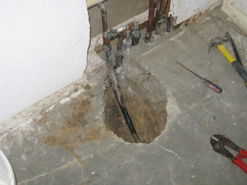

I gave American Leak Detectors a call at 6:30 this morning. Girl said they get in around 9:00AM.
As I write this the water is off at the meter and the power is off to the hot water heater YET the HWH is making a sound like it is draining. I can turn the input to the tank off but not the outputs (only the one value).
It's not GULP-GULP-GULP its more like TICK-TICK-TICK skip a beat TICK-TICK-TICK skip a beat.
Why would the HWH drain with no faucets turned on ?
Thanks as always.

Hmm - I thought I posted the results of the leak detector's visit but I don't see it here.
He was here between 1-2 hours. Nice guy. Been doing it 15 years. He charged $350 which is their stock price. They don't charge if they don't find the leak.
He found a leak smack in the middle of the floor about midway between the manifold / HWH in the garage and the pipes under the kitchen sink. We now have a large penciled X to mark the spot.

My excavation:
Husband of wife's good friend is a plumber and we got him to do the soldering. Although I'm pretty good at it, there were multiple problems and it really needed a professional's touch.
