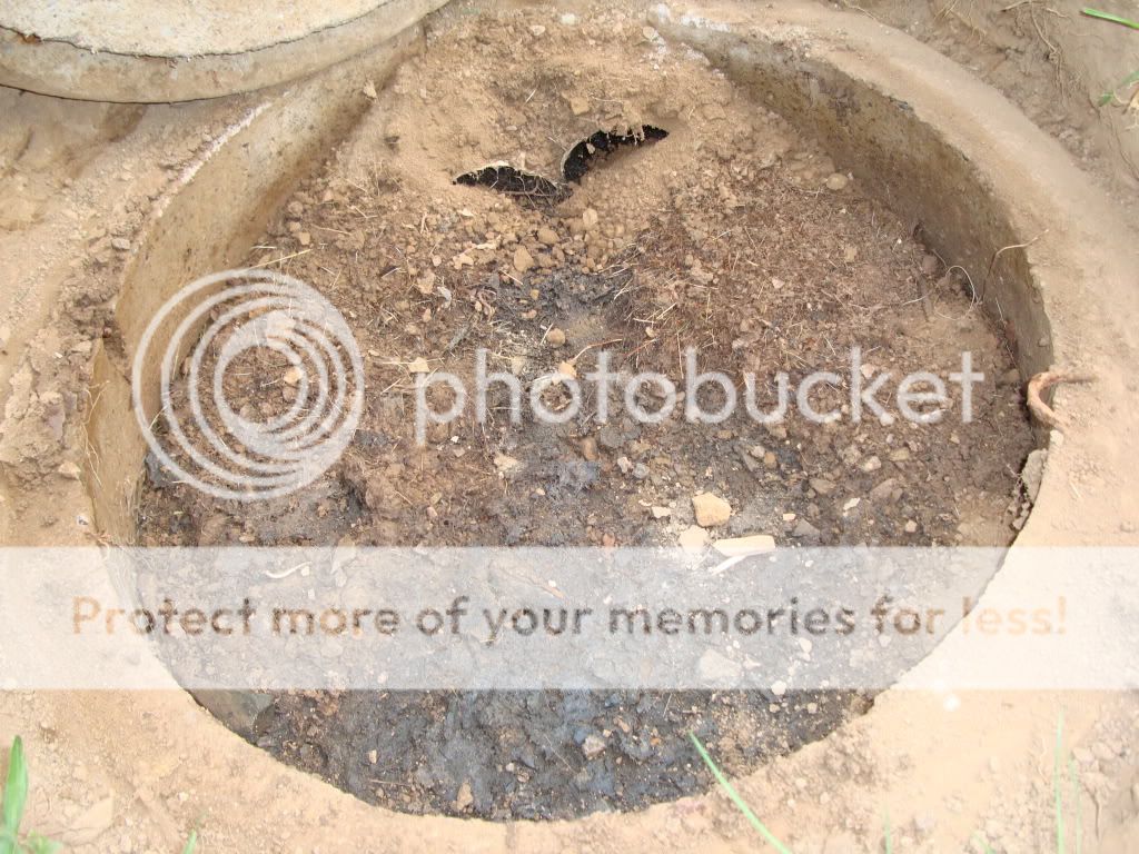

I found the 2 septic tanks and opened up the manhole covers (please see pic below) . I didn’t really measure the scum level and the sludge level. But the top of the scum layer is about 1 foot below the bottom of the riser. Using the stick it feels like mostly water in the first tank about 4 feet deep, then it feels solid. Same in the second tank except that after 4 feet of water it feels like about a foot of sludge. Maybe the sludge is more solid in the first tank? Didn’t really do a thorough job, but doesn’t seem like a lot of sludge to me in either tank!
I did not look for the secondary gravel seepage pit identified by the inspector (4 above). But I cannot find any wet spots outside anywhere and there is no smell of sewage outside anywhere. In short, I don’t see any changes outside.
I flushed the upstairs toilet and looked down the riser in the first tank, but I didn’t see a ripple or a bubble or anything in the water? Does that indicate the problem is before first tank - or possibly right at input to first tank? I was reading about those concrete baffles, but I can’t see anything when I look down the riser except the top of the water (scum) about a foot below the bottom of the riser.

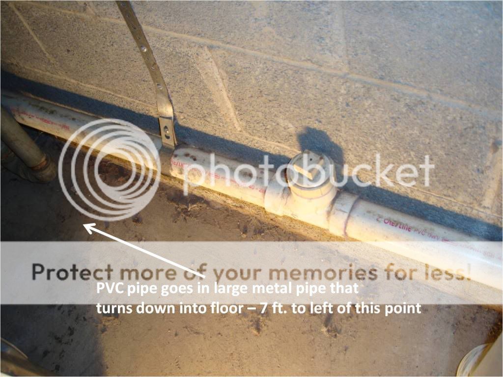

The above picture shows the large pipe that goes into the basement floor depicted in the diagram above. This is right next to the wall for the room with the toilet and sink. No other drain pipes (except for the sink and toilet) go into the floor. I thought there was supposed to be a cleanout right there at the main pipe as it enters the floor? There is a cleanout on the 2 inch PVC pipe that connects to this main pipe in the picture. The cleanout is on that 2 inch pipe about 7 feet to the right. (At least I think it’s a cleanout? Please see pic below).
This above is another view of the main pipe that goes down into the basement floor.

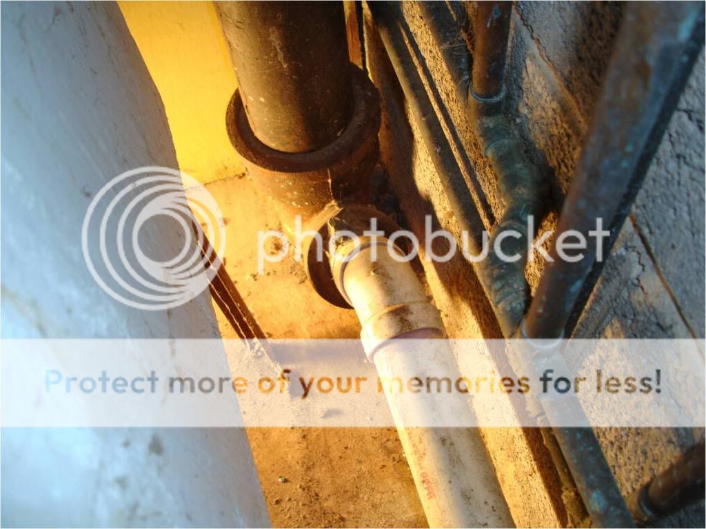

The above picture shows the 2 inch PVC pipe that connects to the main metal pipe that goes down into the basement floor (see pic above).
The above picture shows the manholes for the 2 septic tanks. Cover to cover is 13 feet. The first tank in the foreground is about 40 feet from the basement. (see diagram above).

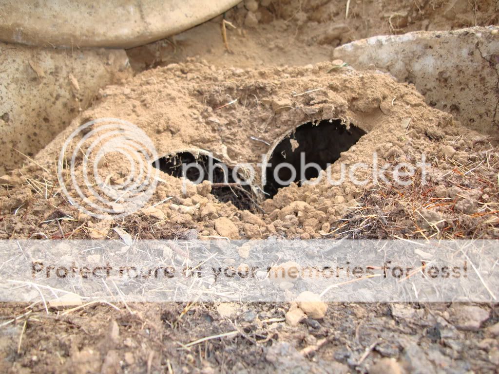

The above picture shows the first tank cover and 2 pipes to the left. The plug on the leftmost is loose and looking down it looks like you can see some liquid down several feet inside. The plug on the pipe in the middle is really stuck. Was trying to open it but I need a better wrench or something. Figure I can’t use a torch or – kabooom! I don’t know what those two pipes are for? I can’t find any such pipe close to the second tank cover? Seems strange. Maybe I have to dig around more?

The big pipe going through the basement floor is obviously the main house drain. The one next to the floor drain could be a cleanout but I don't know. It could also be a separate pipe going to the second septic tank or to the leaching pit for use of a clothes washer to avoid the wash water from going into the primary septic tank.

You need to pump the the tanks and find the lid to the seepage pit.
Once you do that flushing the toilet will tell you what tank the sewer is dumping in.
Second tank may be a cess pool. and the seepage pit may have been added on at a later date. They normally did stuff like that.
Once you pump you will know what type of tanks they are. If the second tank has holes in the side, the bottom is most likely open. Thats why you feel there is more sludge.
As far as the 3rd tank. if you find that and its full of water you have an issue.
After you pump and identify, we can help you further.

hi again guys –
I found the seepage pit 25 feet south of septic tank 2 at the bottom of the slope (please see pics below). What a shock! Not overflowing with water. Looks like it hasn’t seen any water for eons. Not what I expected.
In 2002 the inspector said :
”… seepage pit that probed to be approximately 10 feet wide and in excess of 4 feet of gravel/aggregate. Access to this component was via a 24 inch diameter concrete manhole extension and cover mounted on top of the stone, with the lid being 4 inches below the surface. Two lines were found to be entering the stone pit access….”
In the picture you can see the 2 lines he referred to . I have used very very little water in the last week, and even before that my usual load is extremely light. But that pit looks really dry- and that dirt piled up in front of the pipes? Could it really have dried out so fast? So I’m wondering if the condition of that pit is saying no water has been getting there for a long time? Oh boy – just occurred to me, does that dirt in front of the pipes indicate the dirt is coming from the pipes? So definitely a break(s) in the pipes somewhere? That would also explain the dirt all over the surface below the manhole cover.
I’m going to probe down under the surface of the pit to determine the water and gravel situation down there. Then I think I’ll put some water in the pit and see how it percolates down over time. That’s what the inspector did when he did his testing (shame I didn’t watch). I guess it’s obvious that’s not where the blockage is, but it seems like it would be important to know if the pit is worth anything. Since septic tank 2 has a lot of water in it, seems like I could add some water to septic tank 2 and I should see it run out one of the pipes in the seepage pit?
Just wanted to do a little more investigation before I get the tanks pumped. I know pumping is a must, but I just wanted to have a little better handle on the system before I bring in help.
I’ll post back with more information.
Thanks!

That pit is NG. Is that dirt to the top? Looks like they filled it, but I could be wrong. I would forget about it. Put the cover on and cover it back up. You may want to use it , but I would just forget it. They normally did not fill them with rock. The tank should of had holes in the sides, open bottom, and gravel put around it.
Search my posts and you will see what I was up against. Mine is a seepage pit. I was supposed to have 3 from my survey. I have one.....
Now your main concern is pit # 2. Once you have it pumped you can look to see if any pipes lead from it. I doubt it.
When they pump tank one, it should be solid. Check the outlet and see what type of baffle it has. I have a filter in mine.
Then pump 2 out, and make sure they suck the sludge good out of the bottom. I mean real good. Its probably a hard biomat crust. You need to brak it all up and suck it out.
Let me know what type of tank 2 is. I reclaimed mine with a product that seemed to work. I used two products, but only one made the water dissapate in a couple of days.
I also bought all low flow showers heads and aerators.
Mike NJ

Gotcha Mike. Thanks.
Turns out there is only a little dirt on the top and then a lot of large stone. I put about a 100 gallons in the pit last night to see what would happen. Put in 30, waited an hour, another 30, waited another hour, and so on. I was surprised that it drained down very fast. No water standing on top.
When I close it up today I’ll probe down just for the heck of it to see how wet it is. But I see what you are saying. The inspectors report never did say that he actually saw water coming into the pit. He said because the system had been pumped and was empty, all he could do was to put water in the seepage pit and see how it drained overnight. And that was OK.
And he said he put a camera in the pipes in the pit and he said the pipe changed from PVC to an older type pipe about half way back to the second tank. Then he also said he couldn’t get the camera all the way back to the second tank. But he didn’t say why? Wish I had been a little smarter at that time and asked why he couldn’t get the camera all the way back from the pit to the tank? Seems like that didn’t make sense at that time.
Seems like you are right. I think that inspector might have been off on a tangent. That so-called seepage pit is probably not part of the system. Maybe it was at one time way back.
