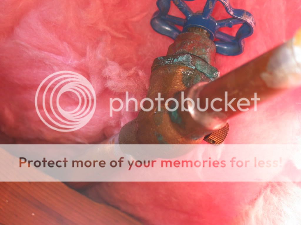

While opening the outside faucet, the handle broke off. Here is a picture of the faucet. (I am seeing couple of terms, hose bib, sil co*k etc not sure what I have). The green handle is broken, Its not rotating the valve that turns water on or off. (and it has turned the valve on ..)

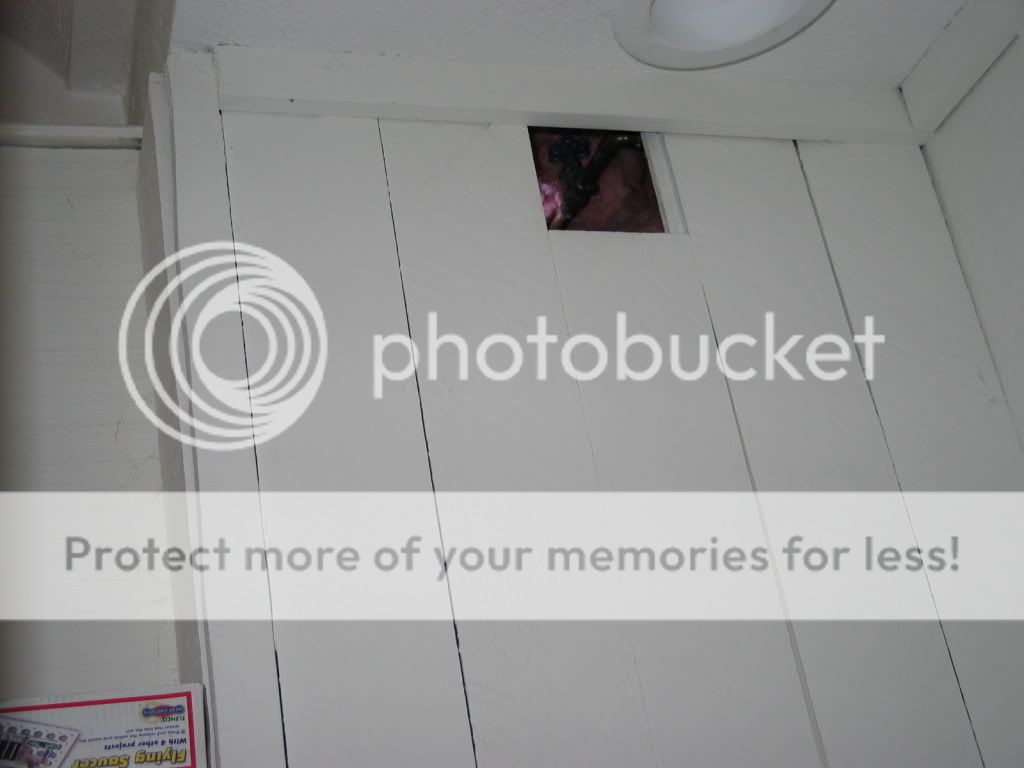

I have a shut off valve just inside the wall. here is a picture of that. I have shut that off.
Here is the basement wall which hides this shut off valve.
Whats the best way to fix it? If it needs to be replaced, I would like to use quarter turn ball valve hose bib (something like this, much easier to turn on or off). I am in MA ..
Thanks

There should be a screw in the center of the handle that holds it on the faucet stem but yours is missing. Pull the handle off (it may need some slight persuading) and see if the screw is actually missing or if it is broken off inside the stem.
The handle attaches to the faucet stem with a spline connection and is held in place by the screw. More likely as not the faucet stem spline is just fine but it is stripped out in the handle as the handle is as soft die-cast metal. If this is true then you can purchase a new handle and screw for a buck or two at any decent hardware store. Amazingly, a huge mega-mart homecenter may not have just the handle but will require you to purchase an entire faucet assembly.
As for replacing the entire faucet with the quarter-turn model...I cannot be certain but I think you have a threaded faucet with a threaded adapter soldered onto the copper piping from the inside shut-off valve and the outside faucet. Theoretically you could just unscrew it from the outside but as a practical matter if you tried this there would be a good chance of twisting (and breaking) the copper piping and it could be before or after that inside shut-off valve. If I were doing the job I would cut the copper downstream of the shut-off valve and then pull the faucet out, replace the outside faucet and re-install the assembly using a soldered coupling at the inside valve. You could also use a "shark bite" no-solder coupling at the inside valve.

I took out to screw since the handle didn't seem to turn the faucet stem. I will post a picture of the broken handle later.
How do I ensure that I have threaded adapter at the end of the copper pipe? Can I ask a helper to hold the inside copper pipe with a pipe wrench (channel lock) and turn the outside faucet with another pipe wrench? Will that ensure that inside water pipe does not break at the solder?

Where the valve is inside the house, see if you could stick your arms in there toward the valve. You should be able to feel if its threaded. Thats if you can reach that far.
You are better off cutting that valve out and replace it with a F/F type. Vacumm breakers are often required.
Amazon.com: LDR 020 6410 10-Inch Frost Proof Sillcock, Chrome Plated: Home Improvement
Shut the inside valve off
Cut the pipe after the valve, and leave 2" or so of copper pipe.
Remove the old hose bib
Get a new hose bib, and solder a length of pipe the length of the old hose bib and pipe. ( if you understand this)
Then when you slip in the new hose bib it should but pipe to pipe where you cut inside the house.
Use a coupling, and solder.
Hope this helps
Mike NJ

thanks Mike ..
I tried and I think I reached the end of the inside wall but did not feel the threads.
I think I do understand what you are saying .. But that is beyond my expertise/confidence. So I would need to hire someone to do it
It seems that just by changing the handle, it might be OK. So I am going to try that first.

I finally got the handle from home depot and found out that the square hole in the handle does not fit the stem that I have. Here is how the existing stem looks
The distance between curved edges is 3/8 while the distance between straight edges is 5/16
I used a file to make the hole on homedepot handle (mueller) match that of the stem. This worked, to an extent. now the handle is fitted on the stem, but the handle can only rotate the stem some distance. The old handle had a protruding circle that could go inside as the handle turned. The homedepot handle is flat and can not go inside as the stem retreats.
Local small hardware shops dont seem to have a replacement handle .. the website of prier does not list any handle that seems to match this description .. Can you guys help me find a replacement handle on the interwebs?
