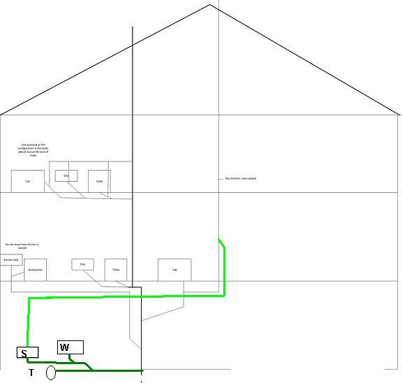

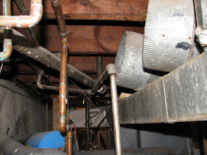

Old 08-10-11, 06:39 AM
chaeberle's Avatar
Join Date: Mar 2007
Posts: 100
I think I've found a solution w/o running a new stack. Someone already did it for me!
Here's the top of the main stack:
The left most pipe comes from the kitchen. The one to the right of it just by the copper goes to the 1st floor bathtub (and JUST the tub).
But - and here's my hope - THIS T's off of the 1st floor bath:
"This" means the horizontal drain pipe running under the joists and elbowing up near the furnace.
Years back this house was converted into two apartments. Later, it was converted back to SFR. The stack rising in this pic goes up to the 2nd floor to what *used* to be a kitchen at one time, and I know it goes up to the roof because I gutted that room a few years back and found this pipe, properly capped it (it had been stuffed w/ a rag) and closed it up again.
So now I can see no reason why I can't tap into this pipe for my new venting. I know it joins into the bathtub drain below the tubs drain, but if I'm understanding this correctly, this *is* the bathtub's vent as well as the old kitchen vent. I can't see any problem with tapping into the old kitchen vent here, even though the tub is technically higher than the point at which I'd tap, because I'd be tapping in on a different branch, like so:
That will work ok, right?

Hi,
Well I have to get the code book out because I cant remember the footage. But first things first.
I was under the impression this bath was in the basement that you wanted to move.
But anyway, is that pipe 3"?
Its capped in a wall on the second floor?
If so you can and will run it through the roof?
Is it 3" all the way up? If not I believe it needs to be but I will check.
All the fixtures have to be I believe 6 ft from that line. If any longer you need a vent.
You know what after looking at it again thats the tub vent. I am almost certain it cannot be done. It may of been ok if the main stack went straight up to the roof ( first pic 4" pvc) But it does not.
And for the tubs sake you should continue that vent. I would suspent the tub trap is being siphoned. ( Gurggling sounds )
If you can draw a better diagram of all the plumbing you can see and whats on the lines possibly there is a solution. I would need a overall of all wastlines, etc...
Mike NJ

Originally Posted by lawrosa View Post
Hi,
Correct - I want to move the bath and washer.
In order:
Yes, 3"
No, it's got a T on floor 2, and the branch off the T is capped.
It already runs all the way to the roof.
Yes, 3" all the way up.
And finally:
Why do fixtures need to be within 6'? If I ran a vent from the roof straight down, fixtures would be 20' from the end vent anyway - what's up with the 6'?
It is acting as the tub vent, yes, but it goes to the roof, so why can't it also be the bath and washer vent?
No, the tub drains fine.
On *that* branch, the diagram I drew is it. The branch drains into the main stack.

Received 60 Votes on 52 Posts
If you took a 1 bath house and had only one 3" main/stack from the ground level up through the roof that bath can be tied in with no additional vents. Once you get so far( I need to check code) say 20 ft away from the stack, a additional 1 1/2 vent needs to be run from that bath and tied into the stack up in the attic. There is a set limit. 6ft,8ft,10ft??? Goes by pipe size and the fixture units. A toilet is 3 units, a sink 1.5, a tub 5 units. You can only vent so many units on a 3" stack befor you need to run a seperate 1 1/2 vent though the roof seperate from the stack.
I know it sound complicated.
Because its considered a wet vent. Wet venting is not to code.
But I believe, and I may be wrong, if that main 4" stack in pic #1 did not elbow and the stack continued up through the roof, that stack would act as the vent for the tub.
But then you would Need to disconnect the "VENT and TO NEW DRAINS" as in pic #3 and take it off the tub and connect it to the 4" ( looks 4" may be 6" )stack anywhere below that elbow.
You see then what you are doing is removeing the tub vent and using it for your bath. But the tub cant use the stack as a vent because it does not continue up through the roof. It has an ell and connects to other fixtures like a toilet I believe I see with a big rubber "fernco". ( Thats not code needs a no hub)
Yes you stated that the vent continues through the roof. I thought it was just capped. Its OK
Sorry but it is what it is. Like I said if you draw all the plumbing as best you can I may be able to figure something out.
And dont get mad a me. You can do what you want. No one will know but you. I am just telling you what is code and what isn't. You may have a slew of venting issues where sewer gas will leak out siphoned traps. Sewer gas can lead to sickness and sometimes death.
I only follow the law and will never suggest doing anything not to code. Although you may be grandfathered in on alot of things, it does not mean they are correct.

Is that basement where the bath is? The basement or first floor your calling it is where that boiler is and bath is?
Take a pic of pic #1 but at floor level. I want to see how that main goes into the floor.
And you said your jackhammering? Where and what location are you tieing in that bath to the main sewer?

Basement and two floors (1 and 2)
There is only a powder room and the washer in basement, and it's those that I wish to move, which will require jack-hammering for the toilet drain, I know. Since I'm disconnecting the old toilet location I expect we'll re-use the below-ground tie-in.
Floors 1 and 2 both have full baths. Floor 1 has a kitchen. Floor 2 USED to have a kitchen which is now gone.
If you look at pic 1, (reproduced for your convenience)
the kitchen comes in on the left hand pip and it joins the main stack nearer the bottom. Both main baths ultimately drain into the main stack EXCEPT the 1st floor tub (a late addition I think).
The 1st floor tub drains into the 3rd stack - the galvanized to PVC 3" that's beside the two copper feeds. That stack branches off at the level where the main stack has the elbow so this pic doesn't show it, and that branch goes off by the furnace and leads up to what was the kitchen and onwards up to the roof.
Again, tonight I will go through the house and try to figure out a more complete and accurate pipe diagram. However, I haven't opened up all the walls before so I'll be guessing at how some of the venting is done, but none of my drains gurgle and all drain smoothly so I'm sure they are all vented, just not sure exactly how.

In the interrim, this is done from memory and is my best guess as to the existing layout. It is the bottom layer sink, toilet and washer that I wish to relocate, and would like to use the smaller stack which shoots off from the 1st tub, if possible.

OK in your second pic I see a tee on that 3" vent your talking about, correct? On one end I would assume is a clean out cap?
1. Are you able to fish a 1 1/2 line next to that 3" line and tie it in either 3 ft above the first floor tub or tie it in anywhere else above that?????
( This would be your best bet and there is your vent for the powder room and laundry. But know you need to plumb correctly at ground level.)
2. If you where to remove that tee and put a Y there and keep the shower vent tied in but continue that #" line down into the floor. No vent needed but the fixtures need to with in the footage 6,8,10ft??? for no additonal venting. The stack will act as the vent.
I hope you understand what I am saying.
You mean up on the 2nd floor? That's not really accessible anymore w/o opening the wall. I put a cap on it when I gutted that room, but I closed it in after.
Yes, I can do that. That runs through our living room wall and I can easily open that up to tap in.
Here you have lost me. Which Tee are you talking about? the one in the basement? I think it likely won't matter because the new location will be at least 6' away from that branch - and the washer more like 30'...
So if I tie into that 3" tub/old kitchen line about halfway up the 1st floor, I can run that as long as I want to be my new vents for the new basement toilet sink and washer, am I understanding that correctly?

OK here is what you need to do to make it work.
Light green vent, dark green sewer under ground. except small sink and washer run into floor. Washer can run along the wall untill you get to where you need but must have continous pitch. 1/4" per ft.
Note: Were the sink and washer hook into the toilet Y, that Y cant be more then I believe 6'8'10 ft from the toilet. Cant recall but keep it close.
And get rid of that little nub on the second floor so no one ever hooks to it.
Mike NJ

Okay I see what you're saying - only the diagram is the "now". Remodel will rearrange sink and toilet and washer locations. Sink and toilet will be w/in 10 feet of the stack - washer will be more like way over on the opposite wall.
But ... based on what you drew, will this work as well?
Er, make that a wye tie in from the washer to the stack, of course.

Yes that looks good to me.
Just hook up the toilet and sink how I show in the pic. From the toilet to the main is 3". The arm coming off is 2". So it would be a 3x2 Y there. Then all light green vent is 1 1/2".
The washer drain 2" vent 1 1/2
And yes use a Y at the washer vent connection. You dont have to run the vant all the way to the washer but needs to be withing 10ft I believe.
Good job...
