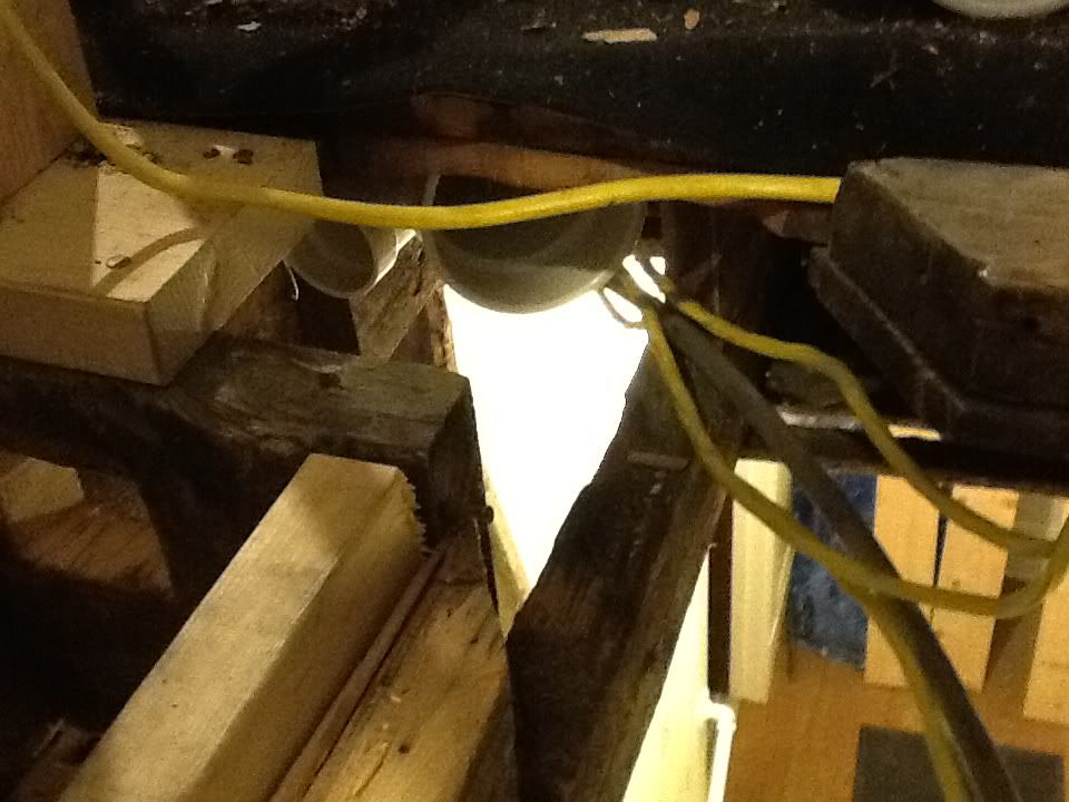

I'm replacing my cast iron stack with PVC and have a question about the toilet drain/bend.
When the house was built, the cast iron stack came up from the basement, cut diagonally across a joist, picked up the 2nd floor toilet, then continued vertically to the roof.
Using the PVC pipe and fittings, the height of the new flange will sit a half inch or more above the finished floor. I have tried every combination of 4" and 3", all degrees, etc., and can't find anything that will leave me flush.
I could lower everything by cutting further into the joist, but as it is, when they built everything they cut about 6" out of the 10" board.
The closest I can get to flush is with a 90 degree elbow. I believe its a vent elbow. (no sweep, female fittings on both ends, no visible hubs). But I'd have to cut off about a 5/8" from one end.
Is that acceptable?

On the lead bend I removed, the distance between the top of the flange and the top of the horizontal pipe was really small, maybe a little over an inch. So the bend on the original was really tight.
But I can't find a PVC bend that tight, and the new 4" PVC tee fitting is larger than the original cast iron. If I didn't have to diagonal across the joist, I could lower the horizontal portion of the stack, and wouldn't need quite so tight a bend to get flush with the floor.
I'll post pictures tomorrow, but in the meantime, is cutting the elbow I mentioned in the previous post a viable option?

I did see your st ell pic, and incredibly, that is the one fitting I did not buy. I think it must have been out of stock, because I grabbed one of absolutely everything. In any case, I'll pick one up tomorrow.
Pics are below. If you can think of anything, would really appreciate your advice.
As you can see, I'm tying the toilet drain into a tee fitting located between the vertical section going to the next bathroom above, and the horizontal section that cuts across the joist before elbowing down to the basement.

The vertical on the tee is going straight up between the two studs, and the toilet will be between the two joists, about 12.5" from the tee hub. I'll use a 22.5 degree fitting to align it.
I should clarify: the top picture includes the tee fitting, but for the bottom picture I removed it to make the "notched" joist more visible.
I was planning on using all 4".

Also that tee you have in the pic branching off for the toilet to the stack needs to be a y with a 45 on the Y end. Needs to be a sweep from vertical to horizontal.
Let me know what you think. Sorry for the fast drawing.

I think I'm going to have to go with 3". Just a couple of final clarifyers:
1. The Y and 45 will work perfectly, but I don't think I'll have room for the reducing Y between the stack and toilet if I use 4". I THINK a 3" reducing Y will fit.
2. If I decided to add a toilet to the 3rd floor, I would still be OK with 3" stack, correct?
3. Just out of curiosity, what is most often used in average homes these days? 3" or 4"?
Can't thank you enough for the help.

Hey Mike. What do you think? Success?

Looks great good job.
Take pics as you go along so we can follow your progress.
What are the two pipes to the right?

The pipes to the right are old radiator pipes that are capped just above the picture I took. They tie into the supply and return pipes that feed the radiator you can see on the side of the picture. I would like to have taken them out, but don't want to drain the system in a Minnesota January, and have to deal with old galvinized piping. So I guess I'll wall them up, and leave them alone. The guys in the heating forum seemed to think that was just fine.
Shacko - Thanks, but its just a dry fit. I was making sure my flange would be flush in the future.
