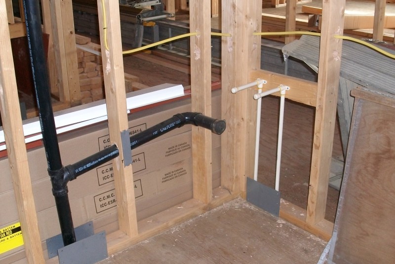

This is just an example, but why move the whole vent? Just cut out the current tee that is there, and install a new tee and arm to where you want the sink to be.
Of course if you need to move the bay just make sure you pitch the vent properly.
