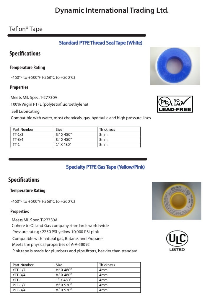

Fuel gas code. ( Says nothing about color...)
403.9.3 Thread compounds.
Thread (joint) compounds (pipe dope) shall be resistant to the action of liquefied petroleum gas or to any other chemical constituents of the gases to be conducted through the piping.
Its all the same stuff, just different colors... ( Its a gimmick IMO...)
In a commercial/hospital setting I believe they may need to use certain colors like use for oxygen lines...etc Yes the pink is thicker and the yellow has a higher psi rating I believe...
Here is one...
http://www.bmicanada.com/products/bmi_specs_teflon.pdf

Well, the yellow/pink stuff is thicker and specifically states it's compatible wit NG, propane, etc. I agree...it's probably a gimmick/non-issue but someone somewhere must have decided it was a good thing?
Who knows if there's some sort of additive in it?
