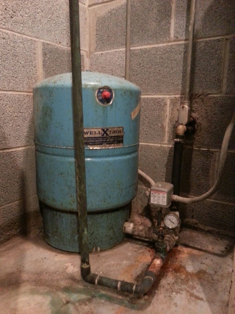

It figures I would get a leak ahead of the main shutoff valve. These nipples on the tank Tee are the only steel in the entire plumbing system and they lasted 45 years so no complaints. What I'd like to know is what should I replace it with? Stick with galv. steel since I'll be long gone before they get to this point again?
There's 1" poly from the pump leading into the tank; 3/4" copper from that first elbow on.

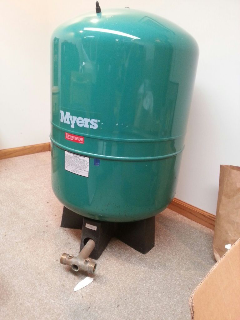

I'm replacing this incredibly small bladder tank:
With this much larger one:
What are the large-OD threads on the tank Tee for? I see the Tees at home centers but have never seen any couplers that would fit the OD threads.

If you have only a small amount of iron, I'd replace it with PVC. The OD parts I usually put Unions on so if the tank ever needs replacing, I don't have to cut all the piping to unscrew stuff. Your switch will attach to one of the smaller ones, put your gauge in the other one and cap off the one in front. Use a brass ball valve for your main shut off ahead of the tank and one after rather than PVC. They are not the best in the world after a few years in service.

I believe the tees accommodate 2 different size pipes. The male threads on the outside are for example 1ď pipe, and the internal threads would be for ĺ ďpipe. So you can take your choice when you connect your piping up to the tee. That OD thread on the tee I believe is just standard pipe size.

Yes Iím positive they are not straight threads but NPT. Here is another one and they indicate the 2 tapped connections are : "3/4 in. female or 1 in. male tapped". I donít know why they donít say NPT on the spec line. It seems like unless otherwise specified it is assumed NPT. At least thatís the way it seems to me.
4 in. x 1 in. Brass Tank Tee No Lead-TC4NL - The Home Depot

So I stop at HD on my way home and buy what I think I'll need for the project. When I check my tank I have 1" ID & 1.25" OD.
Back to the store in the morning :-/

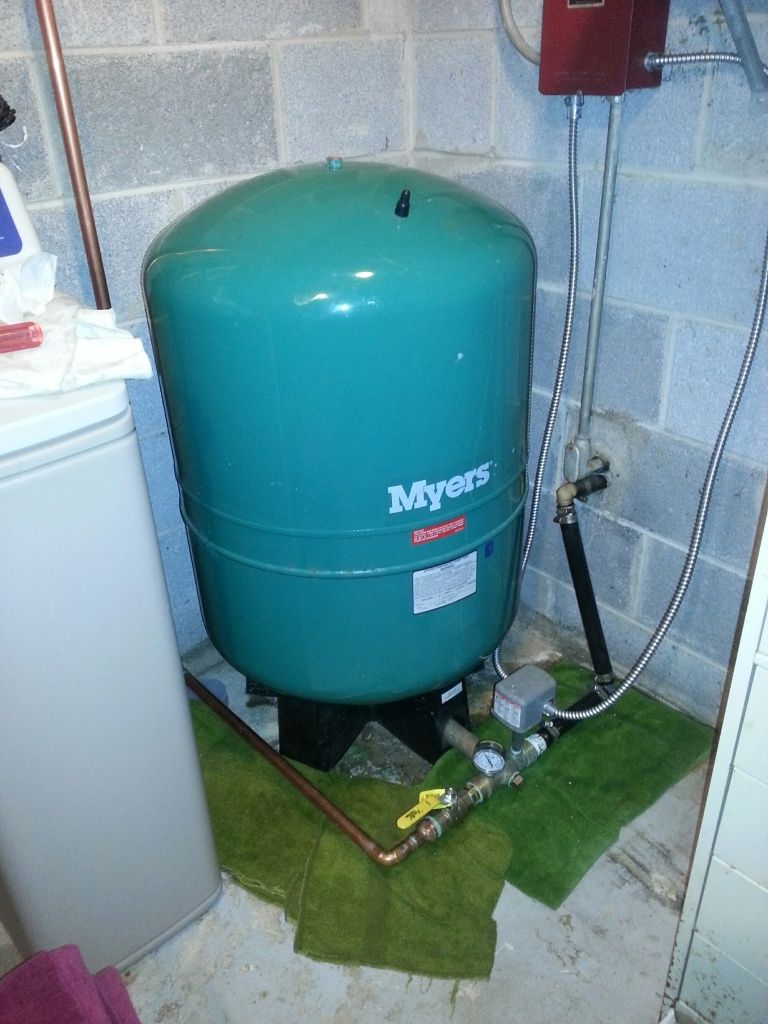

Tank is installed...but not without issues. Notice the towels? All my sweated connections are perfect but most of the threaded or barbed joints leak. I heated the poly tube and pressed onto each barb, then tightened a hose clamp over each barb. I used green pipe dope generously on each threaded joint. It's also leaking from under the tank where I can't see the source. This is a (slightly) used tank that already had the Tee attached--so maybe that's what's leaking there, too. Fortunately under the tank is just an elbow. It's not the kind with the big plastic portal that allows the diaphragm to be replaced.
What could I do differently?

Post #2 suggested unions. I don't see any. You'll never get it tight, now.

I’m no expert for sure but I redid my tank and all the same kind of piping and stuff you show. I had heard that many plumbers use tape AND pipe dope on the threaded connections. So I use a couple of wraps of Teflon tape coated with Rectorseal #5 (yellow mustard color gooey stuff) and tighten the joint really good. That seems to work – no drips on threaded joints for me. And I use to get drips on threaded connections just using tape or dope.
I also heard that many times diyers are afraid to really tighten up joints and that is the cause of many leaks. But maybe a lot of plumbers would dispute that. Anyway, the dope on tape and really using a lot of muscle on threaded joints (but not too much) seems to have eliminated leaky connections for me.
It looks like the fittings you are using for the black poly are plastic. But maybe I’m not seeing them correctly. I use brass fittings and 2 hose clamps. I believe it is recommended to use 2 clamps at each connection where they are rotated with the clamp tightening screws 180 degrees apart. I haven’t had any drips doing that.
Maybe the plastic fittings and the use of just one clamp is causing leaks. I know when I pushed the brass fitting into the poly it was really difficult (no impossible) to do until I heated the black poly while really pushing the barb into the pipe (or the pipe over the barb). It seemed to take a lot of force to get it all the way in. So I would assume it should have taken a lot of force to push the barb into the pipe in your case. If not that may indicate the fit was not good. I think the barb has to be pushed all the way into the pipe, all the way up to the fitting shoulder. But it looks like you may have done that.

The fit felt right -- heated till pliable but not soft, took some effort to push barbs on, visible bulge over barbs indicating poly had conformed. Whatever. Should I have used glue or a sealant?

As far as I know you donít use glue or sealant of any kind, just the barb with 2 hose clamps. Maybe one of the pros will jump in and take a crack at what could have gone wrong. Maybe the 2 clamps vs. one makes a big difference.

Thanks for the encouraging words, zoesdad! I took everything apart, double sealed and double clamped everything. Leak-free now.
