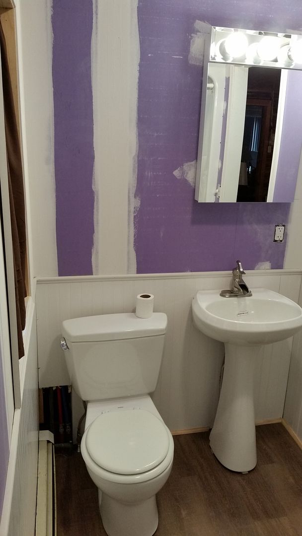

I've never installed a pedestal sink before so I don't know if the problem I ran into is typical. I slid the unit into position, leveled the sink side-side and fore-aft (temporary shims), marked the wall with the outline and bracket & screw locations per instructions. After mounting the sink to the wall I slid the pedestal back in and to get it to fully contact the bottom of the sink I needed to add quite a few shims to compensate for the unlevel floor. This looks like more than should be covered over with caulk.
Is there a moldable putty that can be pushed into the gap that will support the pedestal once it sets up hard?

I recommend you remove the sink and lower the mounting bracket.
If you don't want to do that, you could build or make some type of base for the pedestal, possibly out of wood using a router.
I've never made a base, lowering the sink would be best looking solution.

Because the base contacts the floor at the right rear corner.

as Guy says, your floor is not level. Put a level on the floor and see what kit indicates. Since you can't lower the sink because the base touches the back end, you can use floor leveler or recess the shims under the base and fill with caulk. That will hide the gap and seal the base and give it stability.

Did you check the level of the floor? You don't need to "support" the pedestal. Just make sure it is sitting on a solid surface on at least 4 corners. Let the gap stay under it. Just use caulk to put a bead around the edge to seal it from water and dirt,

I found an online reference to a mortar fill around toilet shims that seems to describe the install in my 1958 home. I think this would be preferable to just caulk under the pedestal.
Once the shims are slid beneath the toiletís base and the bowl is steadied, they need to be held in place. Caulking can be used to both hide and hold them. However, my favorite method is to pack and wipe a clean joint of tile grout where the toilet meets the floor. It not only hides and holds the shims, it acts as filler between all the gaps and once the grout is set up, it does a great job of preventing movement.

Actually I was going to suggest white thinset mortar. If you go with grout use sanded grout. Sanded grout is designed to hold together in larger gaps

Caulk is not the way, that's a huge gap. I don't like it but here's what I would do:
Tape off the floor the best you can in the profile of the pedestal bottom.
Fill the gap with setting type joint compound (hot mud). Take your time filling the joint, 20 minute mud will dry hard in about 45 minutes but wait longer and apply it in several coats. Fill the majority and go back for the final one or two finishing fills.
Use sandable hot mud and sand it to match the pedestal profile best you can.
For paint you might have to experiment with what shade of white and sheen looks best.

Great ideas--thanks. I realize the pedestal doesn't hold up the sink but I want a strong base in case someone leans hard on the sink. The pedestal was my wifes idea--I don't like them.
The floor isn't as tilted as the gap makes it look. I had to tip the pedestal back a little because the it hits the drain pipe at the left corner and the trap on the right side a little bit before it's in the correct position. This doubled the gap at the floor but was the best compromise. Everything is "improvise, adapt, compromise" in a log cabin!

The s-trap shown in the picture is no longer code in most areas because water can siphon out of the trap leaving it dry and letting sewer gas in. Only P traps are code. Is the drain even vented?
