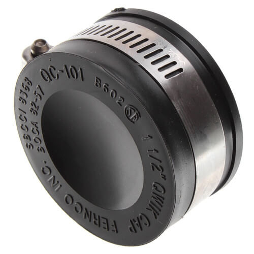

Called plumber who went under house and said there was a vent pipe not capped so he duct taped it up
If he actually used duct tape, you need to find a new plumber. Duct tape is great for reattaching a bumper to a car, but has no place in plumbing!
It should have been capped with either a cemented on PVC cap, or a rubber cap like this
Also, if a pipe is cracked, I wouldn't rely on a rubber boot to fix it for any long period of time.
It sounds like you need someone to take a look at your plumbing and get it up to snuff! We can help of course, but it depends if you want to get into plumbing yourself.
Do you have any unused or rarely used shower, sink, or floor drains in the house? The traps can dry out after a few weeks and provide another way for stink to get in.
Do you hear any gurgling when you flush toilets and such?
